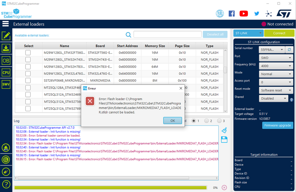

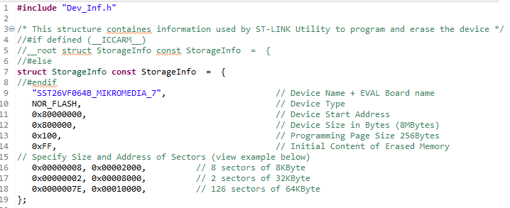

I'm working on the Mikromedia 7 Capacitive board and I'd like to store my fonts and images in my external Flash Memory, the SST26VF064B. I searched in /bin/ExternalLoader and there is no example for this Flash.
So I decided to make my own, following this documentation with dev_inf and loader_src files : https://www.st.com/resource/en/user_manual/dm00403500-stm32cubeprogrammer-software-description-stmicroelectronics.pdf#page=25
But, I don't manage to have my .stldr file working. It seems like this :
Do you have already an example of an external loader for this SST26VF064B or would you have some advice to make my own. Thanks!

External loaders are a bit of a minefield. Here it looks like it fails to pulling the StorageInfo structure from the .ELF file. Perhaps an issue with the Linker Script
Most people are using Micron and Winbond parts, and to some lesser extent Macronix. I can usually fixture SOP16(W) / SOIC16 300mil parts
The ordering/size of the SST26VF064B seems significantly more awkward and complex than your table describes. I'd be half tempted to say they were all 4KB
4, 8192,
1, 32768,
126, 65536,
1, 32768,
4, 8192

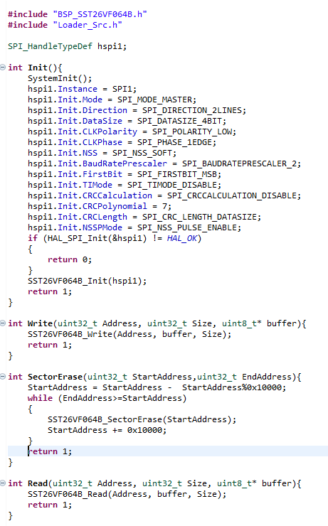

STM32 Cube Programmer will throw you an address range, so expect that your Erase() function will need to unpack the boundaries too.
Generally I'd recommend building and testing your read, write, erase code and functionality outside of the loader first
I'd also suggest using the type SPI_FLASH, and providing a Read() function, as this avoids a lot of issues entering/exiting Memory Mapped mode continually.

Thanks Tesla, I've looked my .elf file in depth and it looks like my dev_inf et loader_src files are not considered in it. Probably an error of properties.

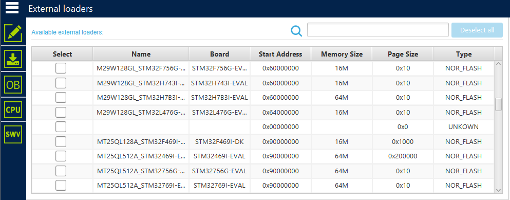

Yes I have a pretty similar loader. Now I can recognize my own external loader in STM32CubePrg, however I can't yet load it, where the error could be from ?
My Dev_Inf and Loader_Src files, the linker script or something else ?
2021-08-18 2:11 AM
As much for me, I've badly called my init() function.. I forgot the great I.

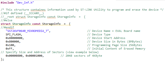

A quick scan of the MikroE schematic suggests this connects as SPI rather than QSPI
You'll need this to be an SPI_FLASH not a NOR_FLASH, and you'll want to implement the Read() function to recover content (historically the programmer has crashed when NOR_FLASH and Read() co-exist)

Thanks for the detail ! My Write, Read and SectorErase functions are working great outside the loader. I just have to focus on my external loader now.
Here is my two files :
Maybe my error could be from my .ld file which is not from my microcontroller specifically but I expect it to work fine.
