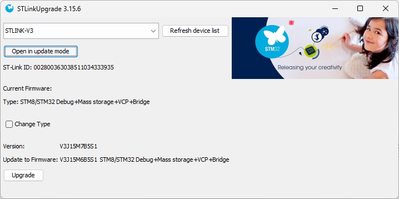

I have just discovered, that the STM32CubeProgrammer will suggest a firmware update.
When running "Help Button | Software Update" it appears...
For my understanding it's a downgrade, that will be introduced
Think this is bug.

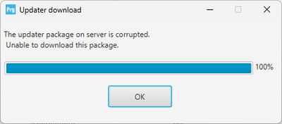

Hello @christian_se ,
By checking internally, indeed it was a server-related issue not to the tool itself and seems to be resolved.
I'm escalating the behavior internally and get back to you for any feedback.
Internal ticket for follow-up: 192048.
