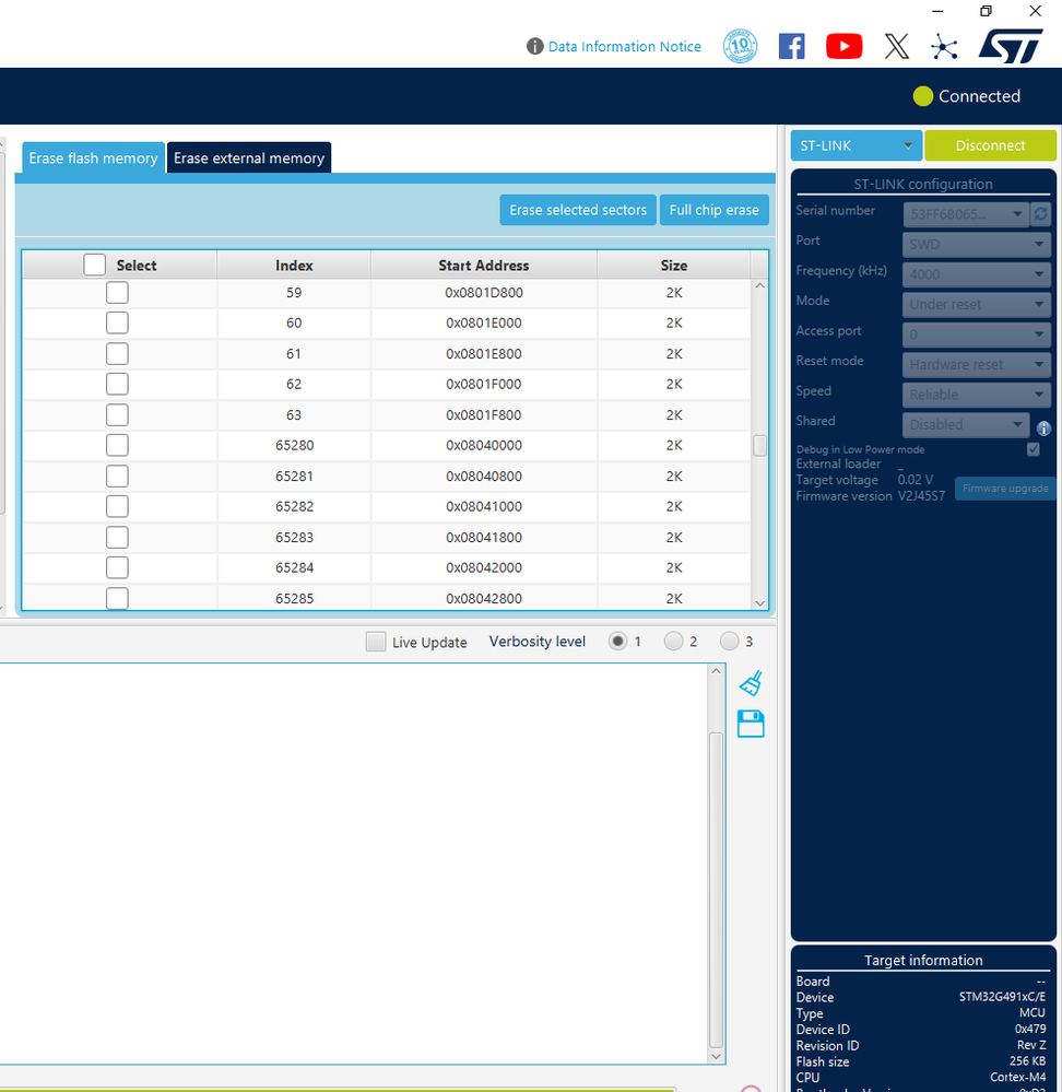

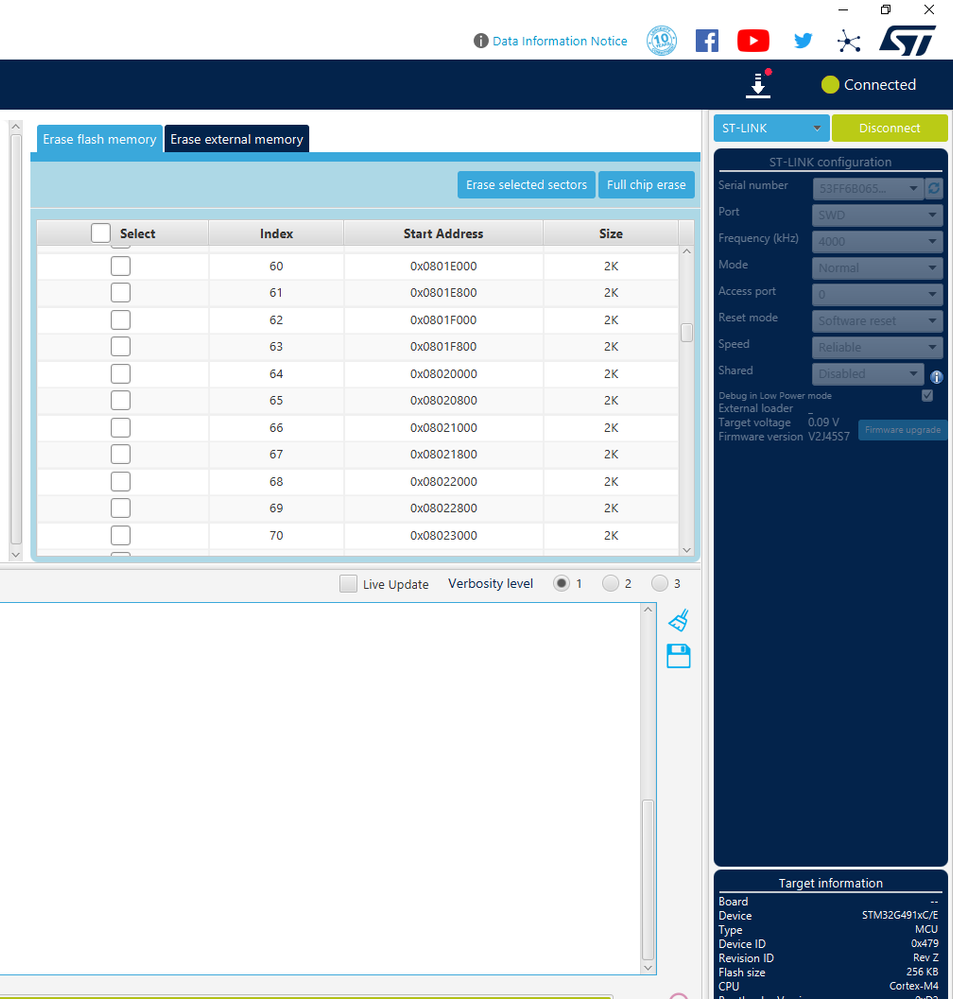

For my project I use a stm32g491rct6 with 256k flash.
STM32CubeProgrammer 2.16.0 show the block contiguos 0-255 from 8000000 to 807ffff while STM32CubeProgrammer 2.17.0 show blocks 0-63 from 8000000 to 801ffff and 65280-65343 from 8040000 to 805ffff.
Whats wrong?Thanks
