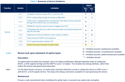

2023-11-30 2:27 AM
In addition to that, the limitation present in the silicon revision Rev B has been removed in the latest silicon revision (Rev Y).
If the option byte programming is interrupted, for example, by a reset or power outage, the BOOT_LOCK bit will be now cleared (=0), which ensures that the debug connection will remain available.
(This applies for the Rev Y. Please refer to the errata sheet ES0412 for more details.)
However, please note that when configuring the Option Bytes manually, for instance in STM32CubeProgrammer, you still need to be careful with RDP level 1 and BOOT_LOCK = 1.

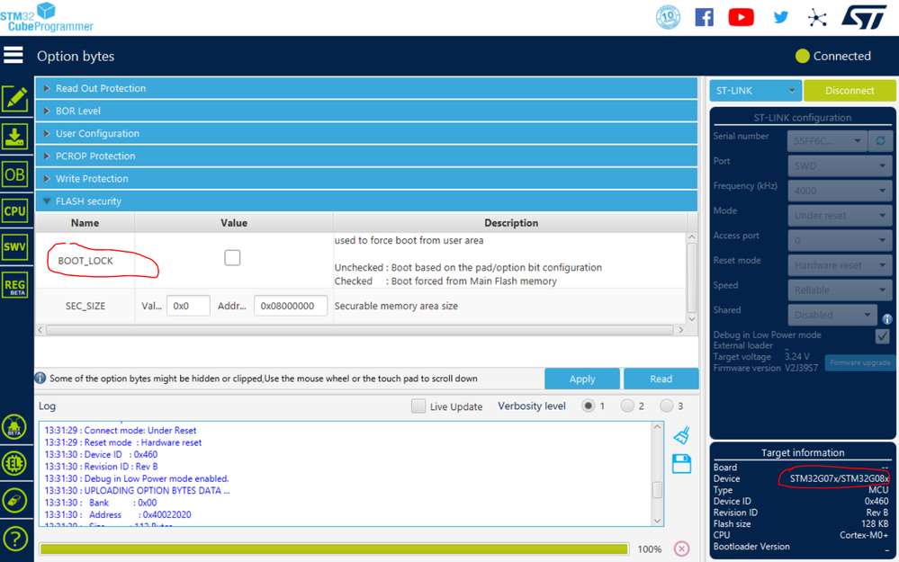

2022-03-21 2:53 AM
I made some tests using a NUCLEO-G071RB board. If I set the BOOT_LOCK = 1 and RDP = 0xBB, the MCU is locked. See the attached piucture.
What is that BOOT_LOCK used for? I cannot find in the reference manual a BOOT_LOCK bit in the Option Bytes.
Thanks

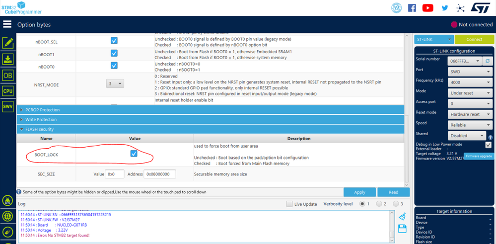

Thank you for the answer, but the link provided does not help me, it is a different situation. I try to be more clear.
With NUCLEO-G071RB:
I set on the NUCLEO-G071RB the BOOT_LOCK bit and I set the RDP to 0xBB. After this I can no more connect to the board! When I press the Connect button in the CubeProgrammer the message is "Error: No STM32 target found!". Everything worked well until I set BOOT_LOCK=1 and RDP=0xBB. Now I cannot clear the read protection because I cannot connect to the board. I have other boards which works, but I do not want to make the experience again...

On my custom board I use STM32G070RB, so the Reference Manual is RM0454, and for these MCUs the BOOT_LOCK bit is not implemented, but it is there in the CubeProgrammer! See the picture. So you can set the BIT_LOCK bit even for STM32G070 and doing BOOT_LOCK=1 and RDP=0xBB gives the same result as for NUCLEO-G071RB: no more connection to the board!
