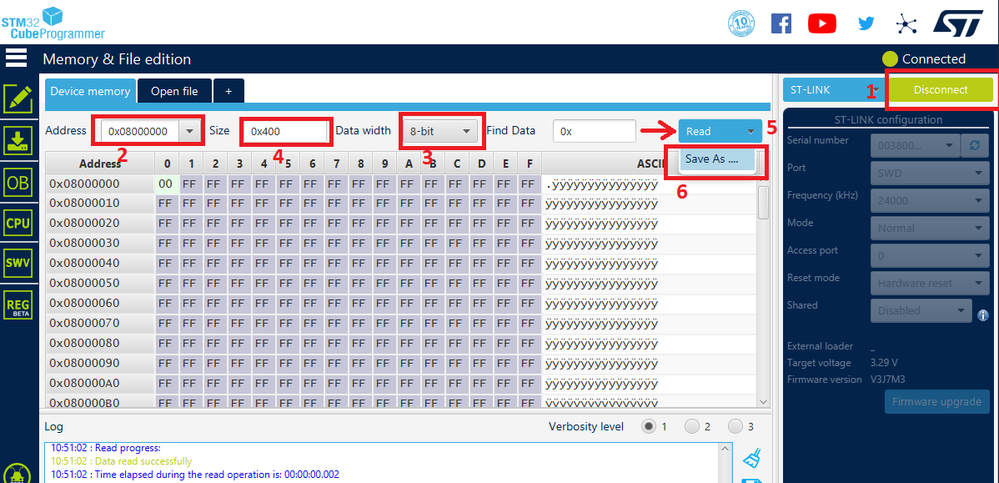

Dear @Community member ,
Procedure to read from MCU memory with STM32CubeProgrammer:
1- Connect your board
2- Select your memory start address.
3- Select 8 bit mode reading
4- The image size in bytes.
5 click "Read" button
6 Save as your file as .hex, .bin etc ..

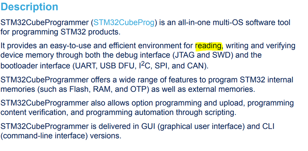

Hello @Community member ,
It is possible to read the flash content using STM32CubeProgrammer (provided you have no flash protection/RDP level 0).
You can check STM32CubeProgrammer software description - User manual , section 2.2.1, for how to do it.

2021-07-09 3:01 AM
If you find this answers to you question please click on "Select as Best".
STM32
2021-07-09 3:22 AM
THanks! @Community member .... it worked!
