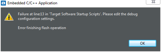

I have a project created in Atollic TrueStudio V9.3.0 which was until recently working without problem. Now when I try and debug the project on my target, the cube programmer crashes at the 'load' stage of the startup script.
I get the following error dialog.

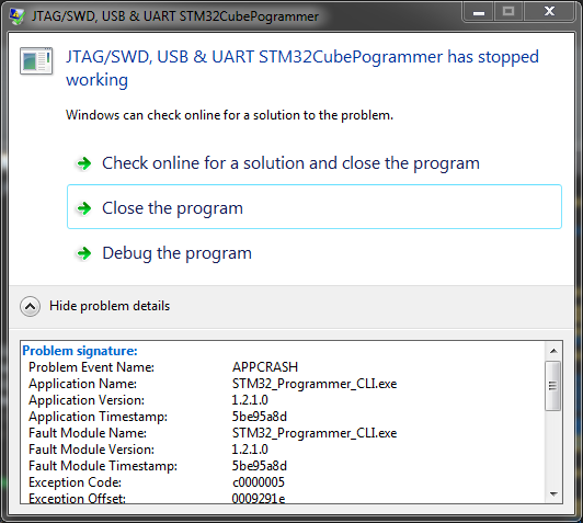

When I close that dialog I get the following
This error also occurs when using the new CubeIDE (which also uses the CubeProgrammer to download).
If I use V9.0 of Atollic studio - which uses the STLink GDB to download the code, I do not have this issue (or if I use a non-Atollic version of Eclipse using GDB).
If I run the CubeProgrammer windows application separately, I can program the device without issue.
I am running WIndows7. I have also tried running TrueStudio 9.3 in a virtual PC (Also running Windows 7) and this works.
My assumption therefore is that something has updated in Windows 7 which is causing a conflict with the STM32CubeProgrammer CLI.
