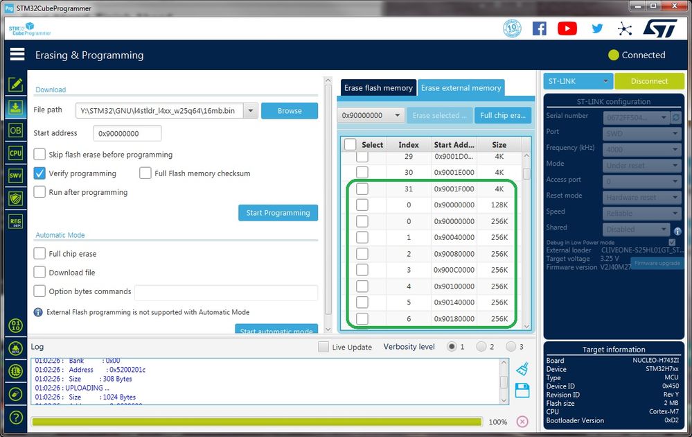

I have an external loader that needs to describe
32 x 4K Erase Blocks
1 x 128KB Erase Block @ 0x90020000
511 x 256KB Erase Blocks @ 0x90040000
The decoding of the base address resets to 0x90000000 for some inexplicable reason

I'm not sure that's necessary to debug a static decode failure on the application side.
The index and address should keep advancing, the order and sequence of the sizing looks correct. So it's reading the table of counts / sizes.
Other aspects of the loader are working properly. And if passed a memory range the Erase function in the loader decomposes it appropriately.
2023-03-22 6:36 AM
Ok, when check boxing the 128KB sector, the one that lives at 0x90020000, the tools pass the loader an EraseSector(0x90000000), so the address computation code is some how broken.

It's an enumerated list of counts and sizes, should be apparent from table in binary
See also trailing comment here
STM32CubeProgrammer_v2.10\bin\ExternalLoader\IS61WV51216BLL_STM3210E-EVAL\Sources\Loader_Files\Dev_Inf.c
Related defines for attached file
#ifdef USE_S25HL01GT // 128MB
#define PART_NAME "S25HL01GT"
#define QSPI_FLASH_SIZE (128 * 1024 * 1024)
#define QSPI_FLASH_SHIFT 27
#define END_BLOCK 0x07FC0000 // 128MB-256KB-1
#define USE_SPANSION
#define USE_ADR32
//#define ERASE_BLOCK_SIZE (256 * 1024)
#define ERASE_BLOCK_SIZE (4 * 1024)
#define COMPLEX1_BLOCK_SIZE (4 * 1024)
#define COMPLEX1_BLOCK_COUNT 32
#define COMPLEX2_BLOCK_SIZE (128 * 1024)
#define COMPLEX2_BLOCK_COUNT 1
#define COMPLEX3_BLOCK_SIZE (256 * 1024)
#define COMPLEX3_BLOCK_COUNT 511
#endif
