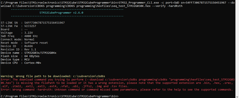

try to put the file name within quotation marks.
-d "you file path/your file name"
and you should write "hardRst" instead of "hardRsth"
2022-07-11 1:00 AM
2022-07-11 1:05 AM
Yes, you are right. The problem is the space in the file path name. Replace the space with a underscore can also solve it. Thank you.
