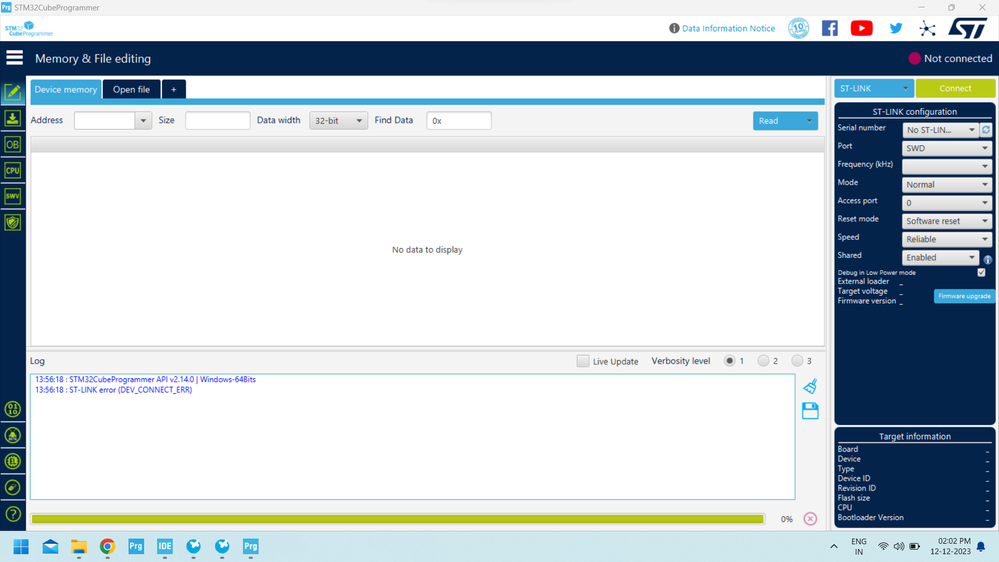

ST Link not recognizing STM Cube Programmer? - From screenshot you can see NO ST Link detected in serial number drop down and has no target information. I can (and did) upgrade firmware, On doing so, it's throwing following error( ST-Link device lost when exiting upgrade mode). Still won't connect. Keep getting "UR connection mode is defined with the HWrst reset mode" log entry.

I'm using wio E5 Development board from seeed(https://wiki.seeedstudio.com/LoRa_E5_Dev_Board/#lorawan-end-node). Also, the ST-Link device is not clone. It was working fine earlier, all of sudden it's throwing error.
