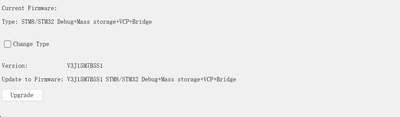

I started to use this stlink v3set since year 2023. All works well until recently it get offline and reconnected immediately sometimes. The red light flashes several times then stays on after connect to USB. The STLINK_V3S disk is opened in an explorer.
The firmware for this programmer set is V3J15M7B5S1. I tried to downgrade it to V3J15M6B5S1 using CubePrg but with no luck.
