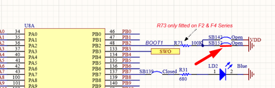

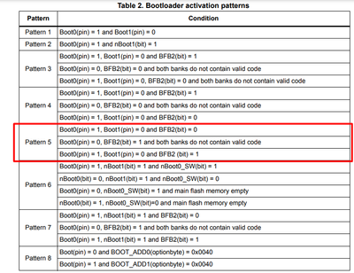

The solution to the problem was simple. I thought that there was no need to modify anything on the Nucleo board, but I was wrong.
By AN2606 this MCU uses:
I tried to check what with this pins on the board:
I connected SB152 and this is the solution to my problem.

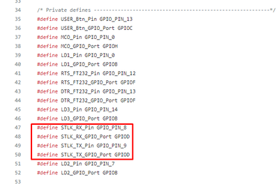

The GitHub doesn't show the MSP code initializing the pins for the USART
Would suggest bring the USART up in your application and sending something to a terminal application. Perhaps using HAL_UART_Transmit() to send a "Hello World!" or similar pattern that you can use to confirm the wiring of the FTDI adapter.

I tried different states of the BOOT0 contact. The board went into bootloader state, which was evidenced by the termination of the internal firmware (the LED is set to blink and the state changes when the button is pressed). At least I think so. Under different conditions, the picture is the same - there is no connection via the COM port.
This should be a simple process: give 1 to BOOT0 and press reset.
Another path followed by UART1 (but I don't use any functions except what I need):

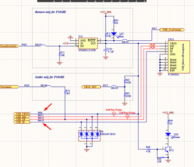

I thought about using UART3 for this purpose (according to the manual I can only use UART1 and UART3), but it just goes to the ST-LINK programmer on the board, I thought that it would interfere with my interaction with the microcontroller. Mb U12 creates problems for me I don't know.

But now I look at this:
And don't understand... Is it not OK? This is UART3 for firmware via the built-in ST-LINK programmer. I get the impression that this is also the problem, but should I define the pins of UART1 like this?
You could monitor the output of USART3.TX into the FTDI RX. You don't want two things driving the USART3.RX pin.
Pick at USART and pin combination that's not conflicted. Surely there are several on the card.
Pull the schematic   https://www.st.com/resource/en/schematic_pack/nucleo_144pins_sch.zip
Pull the data sheet for pins usages   https://www.st.com/resource/en/datasheet/stm32f429zi.pdf
PC6/PC7 (USART6) look unconflicted, there's probably others.

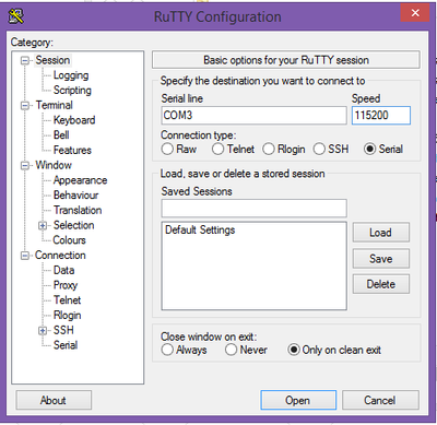

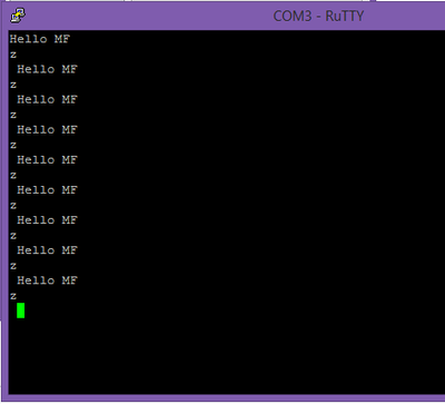

I decided to try HAL_UART_Transmit.
I downloaded such a program, entered the parameters of my port and everything works great.
look, everythin is fine:
Even the LEDs show me the status of RTS and DTR. It’s strange for some reason that with such a connection they change states. I think I need to look at the FT232R documentation.
