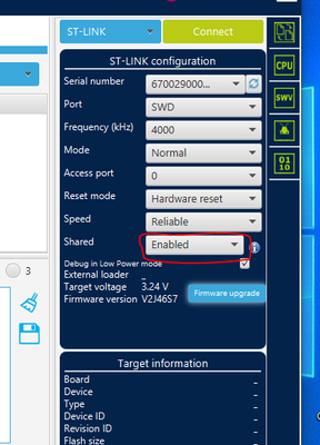

2025-01-15 7:58 AM
Is it possible to leave the default configuration every time you start the STMcube programmer?
Is the Shared option set to Enabled?
In the file: \STMicroelectronics\STM32CubeProgrammer\config.properties
I can't find any "Shared" variable.
The version of STMcube programmer is 2.18.0
