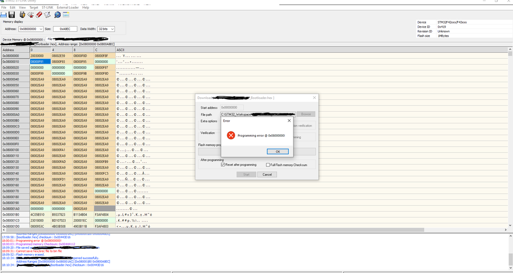

Here is the error message from St-Link Utility (Programming error @ 0x08000000!) :

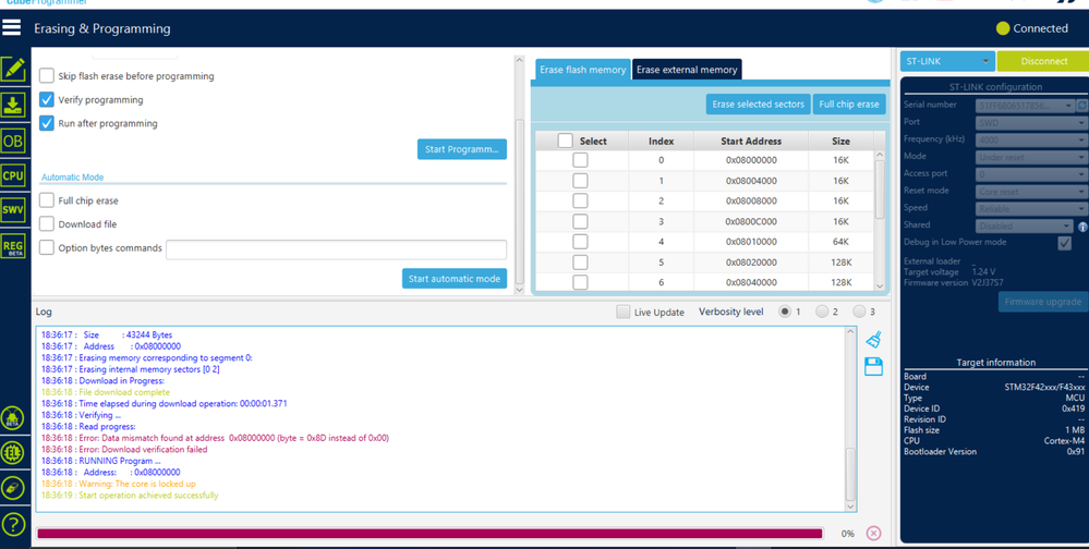

Here is the error message from STM32CubeProgrammer (Error: Data mismatch found at address 0x08000000 (byte = 0x8D instead of 0x00)) :

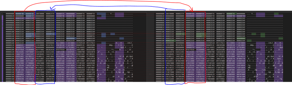

Here is the difference between the data flashed in the chip and the data from the binary file I tried to flashed. As you can see the data are in reverse order.
Could you please help me understand what is causing this problem and how to solve it.
