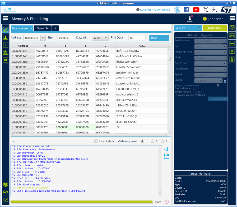

2025-12-20 7:03 AM - edited 2025-12-20 7:06 AM
I usually use something like the signature string as well.
But additionally I have my version control system update the content automatically. I use subversion usually, but other VCSs work similiar.
Probably all VCS are able to replace specific patterns in a file with some content, e.g. replace "$Rev: any text$" with "$Rev: 76 $" if the file is at revision 76 in the VCS.
In my C source it looks like this:
const char *whoami __attribute__ ((section (".init"))) = "$HeadURL: svn+ssh://klaus@myserver.xxx/svn/stm32workspace/trunk/NUCLEO-F030R8_test_doubleprecision/Core/Src/main.c $ $Rev: 76 $ $Date: 2025-12-20 12:02:11 +0100 (Sa, 20. Dez 2025) $";(no, my server is NOT myserver.xxx)
To make subversion do so it is necessary to set an attribute on the file like:
svn propset svn:keywords "Date Revision HeadURL Author Id" main.cOther VCS require some similiar setting. Perforce requires in p4v to make a setting on the file properties in "Change Filetype..."; check "+k" or "+ky" there. Git has no sequential rev numbers but arbitrary hashes instead, see https://stackoverflow.com/questions/1792838/how-do-i-enable-the-ident-string-for-a-git-repository (I try to avoid git...).
A note on the __attribute__ ((section (".init"))): It is a bit dirty admittedly. You can omit this if you really use the string somewhere in your program, e.g. write it to UART.
But if you do not use it gcc will drop the string. This can be avoided with __attribute((used)). Then the string goes into the object file, but will be dropped when flashing because it goes to a section like .rodata.whoami which has no KEEP in the linker config (*.ld). You could force the linker to keep it by fixing the ld file (see https://community.st.com/t5/stm32cubeide-mcus/used-attribute-appears-ineffective/td-p/692448 for a similiar problem with a BSS variable). But I am too lazy to adapt the ld file for this and want to have a simple setting in the C source only. This is why I abuse .init section for this with STM projects - this section will not be dropped by the linker.
Then the Id string will be found in the source, the object file, in the ELF and in the flash as well; see attached png.
The effort is really low: I copy the single code line from an existing project to main.c in a new project and set the file property with the VCS. That's all, the content of the Id string will be wrong until the VCS touches the file for the first time.
This workflow requires using a VCS. But if you do not use it up to now you should consider this anyway...
