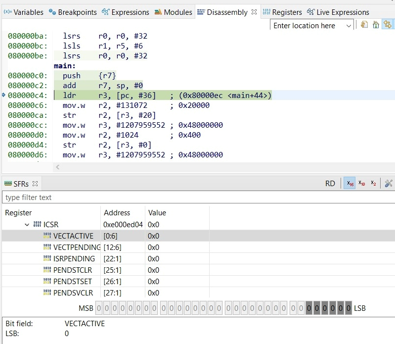

2021-12-14 8:22 AM
I found a small error in the makefile and fixed it, but the behaviour remains the same (MCU was set to cortex-m4 instead of cortex-m0).

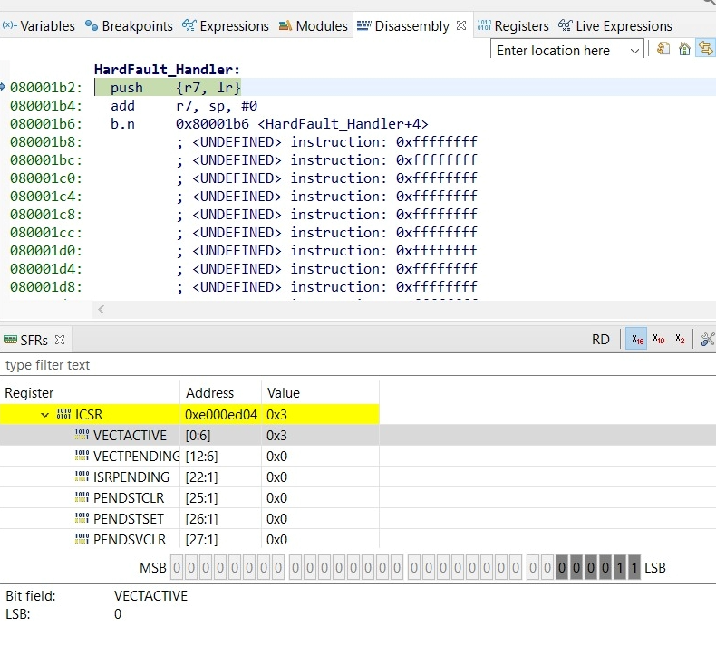

I also found the option to set the program counter to a certain address in the CubeIDE debugger and set it to 0x08000000. After that I went through step by step. Unfortunately it justs steps through the vector table and went right into the hardfault after executing the 4th instruction of main.
I even forced it to the address of the reset handler with the same result.
It looked like this:

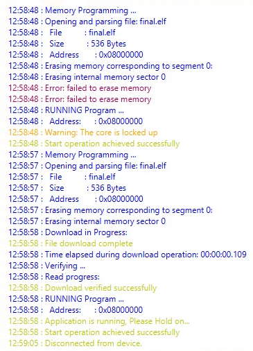

2021-12-21 9:18 AM
Ok, it seems like it was a problem with the board and/or its initial programming.
I don't really know what happend, but the exact same project I posted before, works without issues right now.
I played around with the Linker Script and at somepoint during flashing I got an error and was not able to access the ST-Link anymore.
After I flashed a working project with the CubeIDE to get it working and tried again, I got the following message with the CubeProgrammer and after that everything works as I would expected it from the beginning.
I don't know what changed, I did a full flash erase before without any progress at all, but even after changing my linker script back to the "problematic" version, it now works fine.
Lastly I even tried a second Nucleo-Board fresh out of the box, I got the same error message/behaviour like shown in the picture and it also worked after this.
So yeah, the problem is solved even in a very unsatisfied way as I still don't know what caused the problem in the first case...
