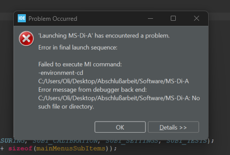

This project here was built and debugged fine last week. Today, I get this message:
'Launching has encounteres a problem.
Error in final launch sequence:
Failed to execute MI command:
-environment-cd
<Path/to/project>
Error message from debugger back end:
<Path/to/project>Here is the whole console output:

There are a lot posts with "Failed to execute MI command" problems here, but I did not find mine. I hope, somebody knows how to fix that. As I said, running and debuging the project worked nice some days ago, and I do not see reason why it does not continue its fluent work today.

2024-09-25 9:55 AM - edited 2024-09-25 9:55 AM
Funny characters in the project path, again. Recipe for trouble.

@Pavel A. wrote:Funny characters in the project path, again. Recipe for trouble.
Yes, that's right, but to be honest, we are not in the eighties anymore even we are still using C. Modern software should be able to handle also no-ASCII-characters, I think. Other software can handle it too.
