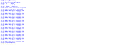

Hello, there is a problem with programming STM32G0Bxx/B1xx/C1xx using STM32CubeProgrammer version 2.16.0
A have a HEX file starting at address 0x8001800 and with length 0x32800.
When programming this using USB DFU, the tool first starts to erase some of the sectors first.
Which is what i expect. Only the number of sectors and the address go wrong. See part of log of the tool:
"14:38:58 : Size : 202.00 KB
14:38:58 : Address : 0x08001800
14:38:58 : Erasing memory corresponding to segment 0:
14:38:58 : Erasing internal memory sectors [1 51]
14:38:58 : erasing sector 0001 @: 0x08000800 done
14:38:58 : erasing sector 0002 @: 0x08001000 done"
As the sector size is 2K for this MCU type, it should erase sector 3 to 103 (or 102)!
And it should start at address 0x80001800!
Please fix asap.
Something similar was already reported by my colleague.
Thanks,
Regards,
Corné

2024-05-13 9:09 AM
STM32G0B1KC is the exact type of the MCU i am using.
When programming a hex file, not starting at 0x8000000 you immediately see the problem with the erases send before the actual programming starts.
Also when just easing individual sectors, you see an error in the calculation of the 'Progam Counter' as the value is called. The value send with the FDU_DOWNLOAD command with wValue = 0 is calculated wrong.
And maybe there is something wrong with the size of the sector. The flash sector size of this MCU is just 2Kbyte.
Not the 4K as shown on that Erase & Programming menu.
