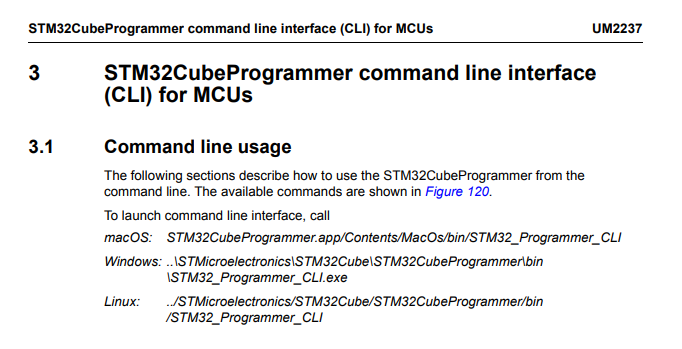

The software package STM32CubeProg contains not only the version with GUI, but also the CLI. When starting it without specifying any parameters, as always, a list of options including some examples is displayed.
Does it answer your question?

2024-06-11 2:56 AM
Take a look at the User Manual:
As usual, all documentation is on the Product Page:
https://www.st.com/en/development-tools/stm32cubeprog.html#documentation
