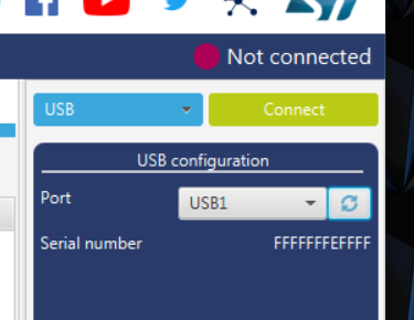

I connect the user USB to my PC with BOOT0 pulled high and sure enough it does detect a dfu device. (the serial number looks fishy though?)

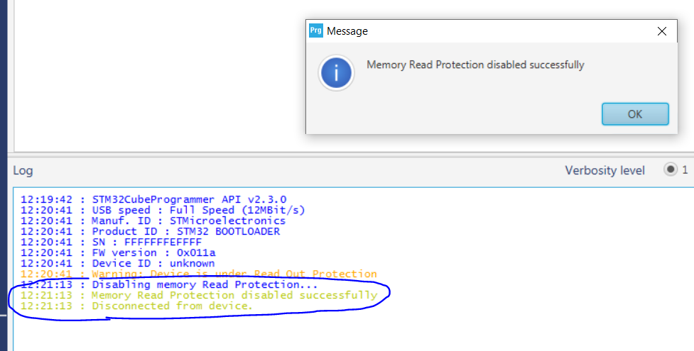

Now if i try and connect it prompts me to disable read protection. which it does sucessfully. but then it disconnects immediately afterwards and if i try again. it will just do the same.
