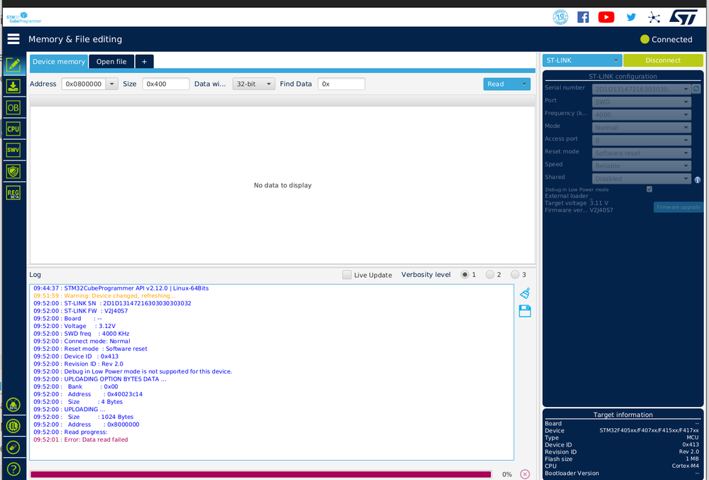

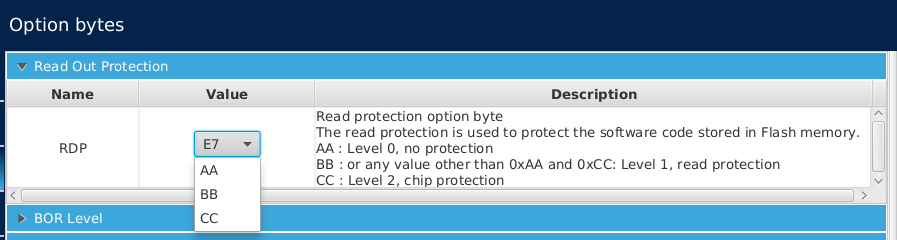

using stm32cubeprogrammer and i get the error - option byte programming failed
expected value for option byte "RDP": 0xAA, found: 0xE7

STM32F405RGT6 running on a vesc board. i am using the gui cube programmer v2.12
2023-01-29 11:44 AM
it also show current value as E7.

Does STM32 Cube Programmer correctly identify the chip? Perhaps show the whole window to provide some context.
You're using an ST-LINK/V2 or V3? Authentic?
Direct USB connection, or via a hub or docking station?
Your board connects/functions otherwise?
What's voltage measured on VCAP pins?
What version of Windows?

@Community member i am using st-link v2 non authentic via direct usb, the board powers on but will not connect via usb and isn't showing usual green led only blue, i have tried on windows 11 and ubuntu 20.
2023-01-31 10:12 AM
Try connecting under reset, checking NRST.
Did you try BOOT0 strapped to VDD?
check this ST video: STM32 Security tips - 3 RDP without POR
