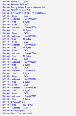

NUCEO-stm32h563zi external loader => data read failed.
I attaching ld file and source file.
let me know how to solve. please
thanks

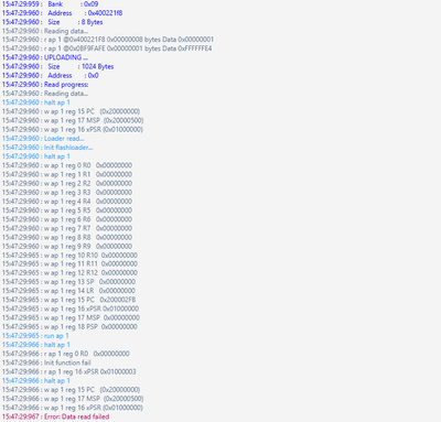

hello
I add log.
Thanks
