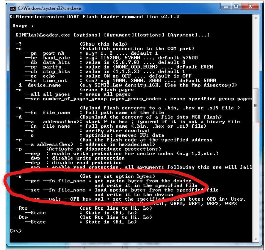

I am trying to migrate from UM0462 Flash Loader Demonstrator to the STM32CubeProgrammer (upon a recommendation from STM, as the former becomes obsolete). Yet I seem to be missing the option of loading OptionByte file.The documentation for cube refers to option byte, but not as a file:

How does one load an OptionByte.hex file, besides the .bin file?
