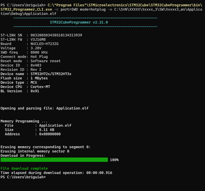

2026-01-26 7:36 AM
Hi Niclas,
Please include the C:\ in the quotes and get back to me. Or simply copy this to a CMD window and screenshot the result.
"C:\Program Files\STMicroelectronics\STM32Cube\STM32CubeProgrammer\bin\STM32_Programmer_CLI.exe" -c port=SWD mode=hotplug -w C:\SVN\XXXXX\Xxxxx_3\SW\Xxxxx3_ws\Application\Debug\Application.elf
Thanks,
Aziz
2026-01-26 7:51 AM
FYI: To prove further that it's a parsing issue, you can test your original scripts (Without my suggested modification) in PowerShell and not Windows CMD, the CLIs will run as expected.
PowerShell
Windows CMD
Looking forward to your reply !
Aziz
2026-01-26 8:23 AM
Hi Aziz,
You are correct. This is a parsing error. Weird that the erase command was parsed correctly but not the program commands.
