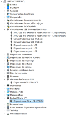

2024-11-06 5:42 AM
Thanks!
The only thing that appears on my device manager is this:
Nothing that says STlink, but i am trying to do the firmware upgrade via USB using STM32CubeProgrammer and putting the MKBOXPRO in DFU mode, not using the STLINK V3 SET debbuger and programmmer.
The usb-C cable is the one from my new phone, that is a data cable too.
And i already tried all the usb ports.
Do you have any other reccomendations?
Shoud i buy the the STLINK V3 SET, debbuger and programmmer, to do the firmware update easier?
