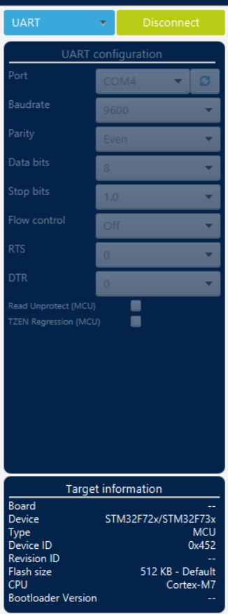

2022-09-08 2:01 AM
Thanks for your replay, in fact, i just managed to communicate with it through UART, putting BOOT0 to high Do you think, that we can work around the SWD connection problem and program all the other functions through UART ?
2022-09-08 3:15 AM
You should be able to program test code and validate other aspects of the design, using the USART as a means to report diagnostic or telemetry.
