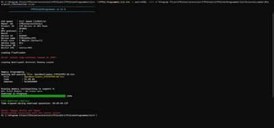

I'm encountering an issue while using an external loader to program an external flash memory (MX25L6433F) on an STM32H563IGK6 board. My objective is to access this external flash (OCTOSPI1) with DFU for operations like erasing, writing, and reading, specifically to download my application into the external flash.
However, when I run the command using STM32CubeProgrammer via the command line, the program loads a bootloader named "STM32H7RS-DK" instead of using my custom bootloader, which is already running on the board.
I have a few questions regarding this behavior:
Why does STM32CubeProgrammer choose to load this "STM32H7RS-DK" bootloader? I understand it is a secure bootloader, but I'm unclear on why it's being selected.
Does this mean my custom bootloader will be ignored or replaced?
What exactly does this choice of bootloader by the program mean, and how can I access my external flash (erase, write, read) while still using my own bootloader?
I've attached a screenshot for more details on the messages displayed.

UPDATE :
I have built my own external loader specifically for my project, ensuring that it matches the configuration of the external flash (MX25L6433F) in my custom bootloader. Despite this, I'm still encountering the error "Cannot copy external loader to SRAM" and the program loads the same bootloader named "STM32H7RS-DK" when connecting with STM32CubeProgrammer in DFU mode. I've attached the latest screenshot showing this issue.
Does anyone have insights into what might be causing this problem? Any advice would be appreciated!

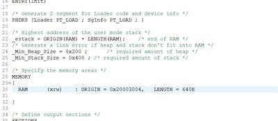

If it's not loading my loader it's because the path is wrong and the file is not where specified.
Check if you need to add quotes around paths/names with spaces.
The H5 external loaders need to live at 0x20003004, as I recall, and not 0x20000004 or 0x24000004, check the loader script (.LD)

I changed the loader script to 0x20003004. The same problem appears.
2024-08-14 10:25 AM
I'm not sure of the reasoning behind the OpenBootloader in this situation.
I will note however that External Loaders have typically NOT been supported in the STM32 DFU mode of the System Loader, nor the UART methods.
The STLDR have typically been used by the ST-LINK SWD/JTAG methods. The application stages the external loader in RAM, and uses other areas of RAM to transfer the content to be programmed, and calls the functions in the external loader to be executed.
To support memories beyond the scope of the ROM's System Loader, you would typically make your own DFU Device, which furnished the address/sizes of the memory regions you support, and back with the QSPI memory devices.
