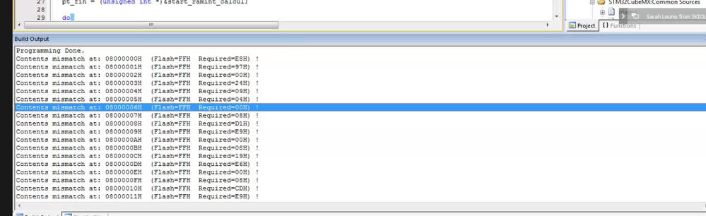

2024-09-04 6:50 AM
No, here's the full error message.

Too many errors to display !
Error: Flash Download failed - "Cortex-M7"

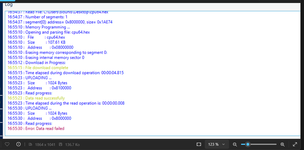

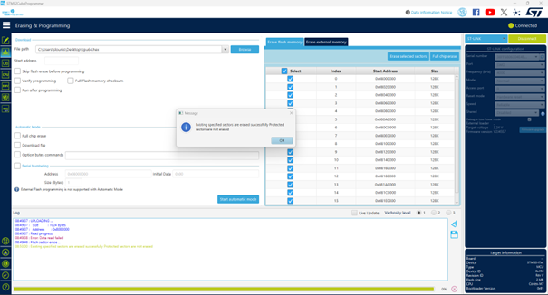

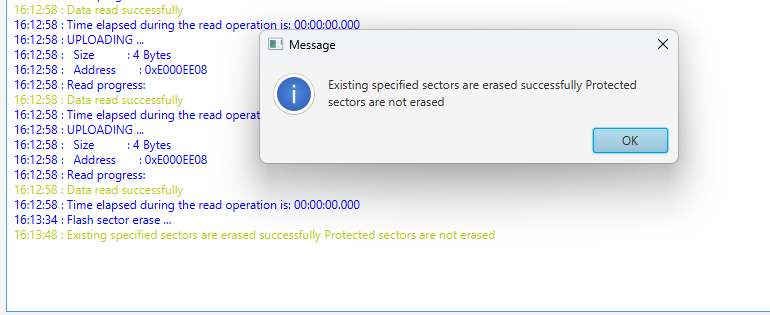

2024-09-04 6:58 AM
When I took the photo, my microcontroller was locked (RDP). Now it's okay, I can delete the sector in the flash, but I received this information (see photo). I think the sector is locked because I can successfully load the .hex file via STM32CubeProgrammer, but right after that, nothing happens, and I get a 'failed to read data' error.
