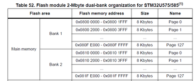

A : Bank 2 base address is 0x08100000 for STM32u575/585 (what is your STM32 ?) You cannot declare the bank 2 with SECWM2_STRT & SECWM2_END in the bank 1 at the address 0x8040000. Here are the two flash area definition for a 2-Mbyte dual-bank on a STM32U5 :

If you want to make 4 partition for storing configurations, the best option is to edit the linker file. (You can also use the memory management tool in CubeMX, click here for more information)
You can check the FLASH_SwapBank of STM32CubeH7 program under the root : "STM32Cube_FW_H7_V1.10.0\Projects\NUCLEO-H743ZI\Examples\FLASH\FLASH_SwapBank" .
This example load two projects : the first in the bank1 at the address 0x08000000 and the second in the bank2 at the address 0x08100000. You can swap between those two banks (projects) using the FLASH HAL API.
