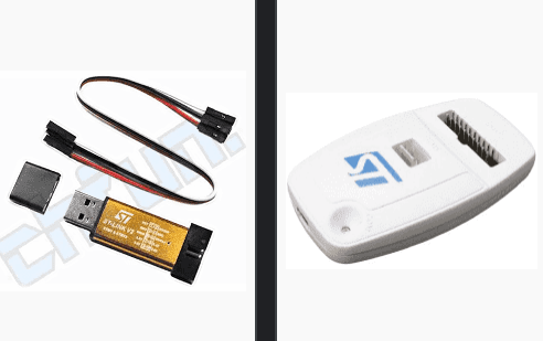

If your board has accessible SWD connector and you/your customer can use an external ST-LINK, this may be the best way. Modern ST-LINKs have both SWD and VCP (UART) interfaces.
If the built-in bootloader of STM32 supports the UART, it may be used too.
Then the RTS output of USB to UART adapter can be connected to BOOT0 to force entry to the bootloader.
SWD interface is more powerful (especially if NRST and SWO are connected), it allows to debug and completely re-program the MCU (think recovery). But it requires extra software: command-line CubeProgrammer subset or something OpenOCD based. Or a professional flasher tool.
On the other hand, the mass-storage like (or even DFU-like) USB interface is easier for the user, but requires at least one additional chip.
Your board need only
0693W00000Y7MGLQA3.pngand or
0693W00000Y7MG1QAN.pngsome info
