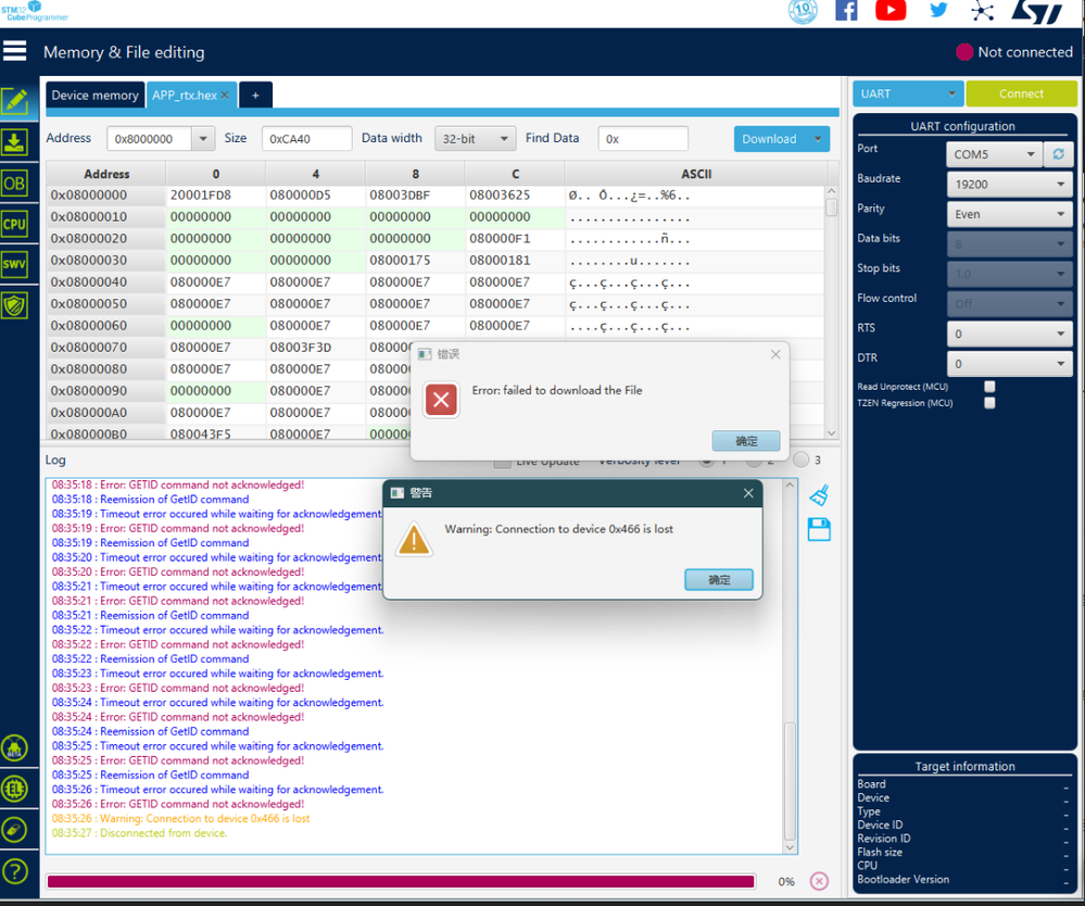

Recently I used Stm32cubeprogrammer to write programs via UART. I can connect to the MCU, I can also read the data, but the download fails.
Have you encountered similar problems?

I can read and write using the SWD interface, but not with UART
2022-12-21 6:02 PM

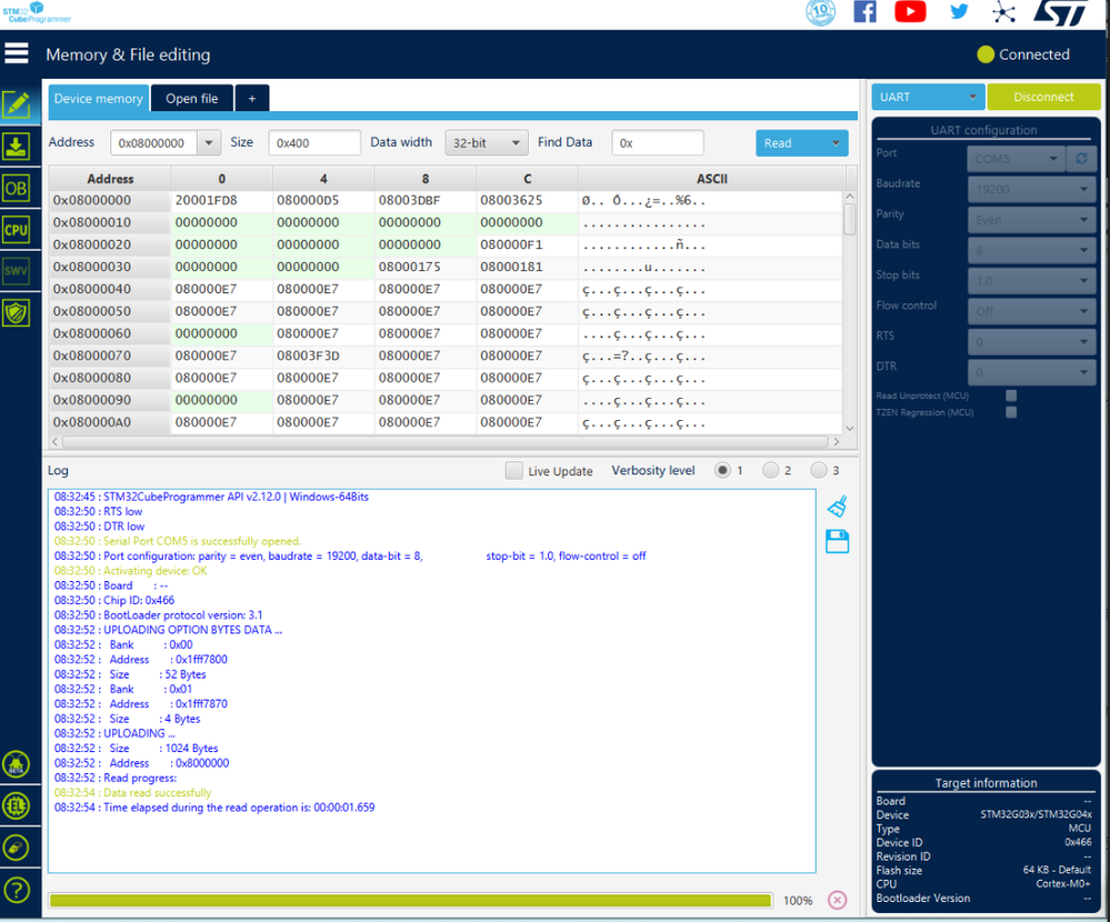

Could you share a screenshot of STM32CubeProgrammer GUI when connected via ST-LINK (To know the bootloader version and the rev ID) ? Could you also specify the full name of the device you're using ?
A verbose 3 log could be useful as well.
Thanks,
Aziz
2023-01-03 10:39 PM
2023-01-03 11:39 PM
Hello @Community member,
There are some limitations in the earlier versions of the bootloader, especially on packages with less than 32 pins (you can check AN2606 page 225 for further details). If you have bootloader V5.2, I suggest keeping PA3 at high level and doing the test with UART1 (PA9, PA10).
