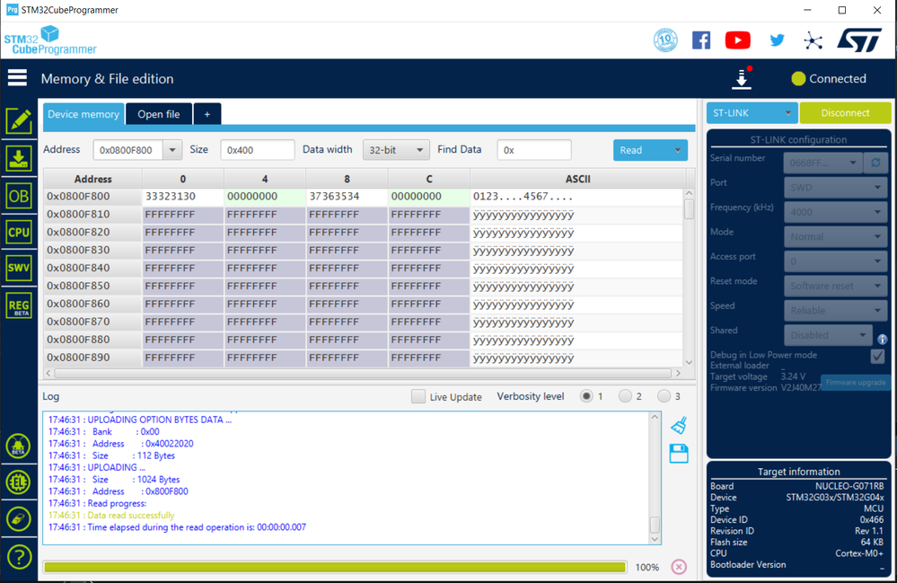

I wish to store data in the flash memory of my STM32G030C8T6 microcontroller. The issue I am facing is that my data is not being stored in contiguous memory banks, but rather the banks are being skipped, as seen from the image.
YBend.1
Associate III
0693W00000Y8sbDQAR.pngI have written a small driver code for the same to store different types of data types to a memory location.

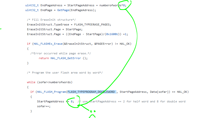

G0 require the Flash memory to be written in units of 64-bit words - check the manual. You cannot write it by words (32-bit), only in pairs.

Thanks for pointing the problem out. Any changes you could please suggest in my code for incorporating this change.

you hardcoded a bunch of 8s and 4s , im sure you skipped/swapped one of those

Thanks a lot Javier for pointing that out,
What should the values be according to you, in place of 8?
Beacuse
uint32_t EndPageAdress = StartPageAddress + numberofwords*4;
and
StartPageAddress += 8;
are yielding the same result.
I am not saying the value shouldnt be 8/4, i meant if those numbers are harcoded like that there is usually a big chance you messed up some.
hit me up in https://www.linkedin.com/in/javiermu%C3%B1oz/
Okay Javier got it,
But I tried multiple values that made sense, but I am getting the same error.
Any other suggestions?
YBend.1
Associate III
@gbm​ ,
Can you please tell me how I can inculcate the change you are suggesting into my code.
Thanks.
gbm
Principal
Look at the EraseInitStruct.Page = statements in your code, one after another. They don't seem to be correct.

I am doing:
EraseInitStruct.Page = StartPage;
EraseInitStruct.NbPages = ((EndPage - StartPage)/(FLASH_PAGE_SIZE)) +1;
whereas in the example code it is
EraseInitStruct.PageAddress = StartPage; EraseInitStruct.NbPages = ((EndPage - StartPage)/FLASH_PAGE_SIZE) +1;
Most probably this is causing the issue.
The definition of Page is: Initial Flash page to erase when page erase is enabled. This parameter must be a value between 0 and (FLASH_PAGE_NB - 1)
and that of PageAddress is: Initial FLASH page address to erase when mass erase is disabled. This parameter must be a number between Min Data = 0x08000000 and Max_Data = FLASH_BANKx_END (x = 1 or 2 depending on devices).
Can you please suggest an alternative to be used for PageAdress for g0 series, as I am not able to identify what the correct variable alternative to PageAdress could be.
