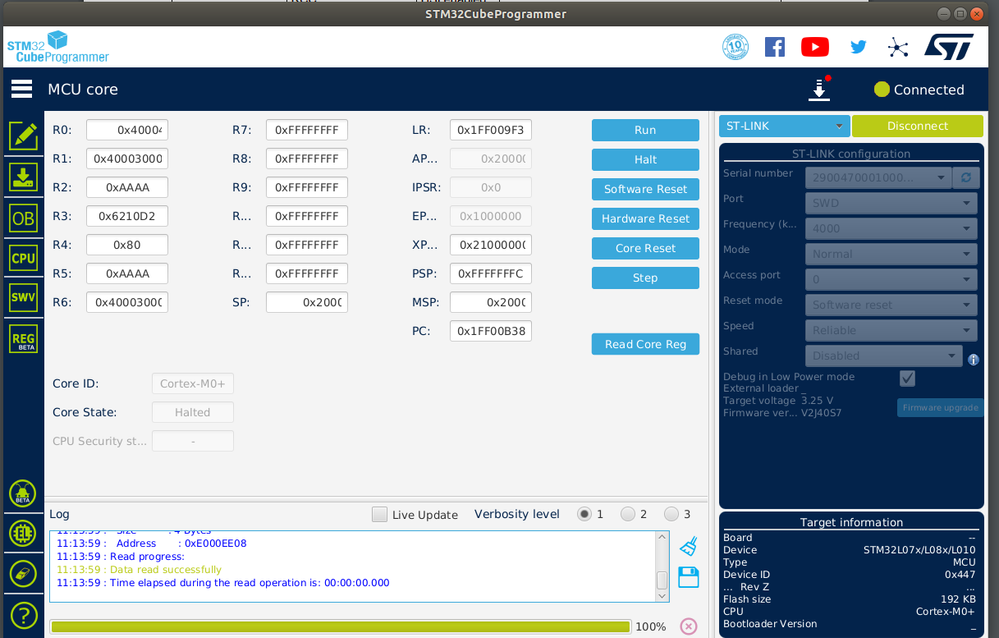

I confirmed that the MCU entered bootloader mode by connecting ST-Link V2 with the MCU and ensured that the PC pointed to the bootloader address(0X1FF00B38) of the STM32L071 series as shown in the image below0693W00000WJ0XVQA1.pngAfter entering system memory mode, if I try to flash the code through UART using STflash tool from Source Forge , I was not able to flash the code. Error shown by the program: Timed out.

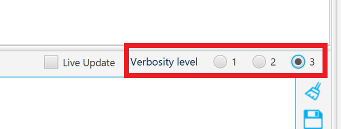

Could you see if you encounter the same issue using STM32CubeProgrammer v2.12.0? You can download the latest release under this link.
If the same issue is encountered, could you share the verbose 3 log file from STM32CubeProgrammer? You can change the verbosity level using this radio button.

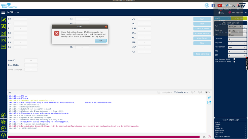

Please find the attached image when trying to flash thought UART mode with Verbosity level set to 3. I had verified that the PC is at 0x1FF00510 ( System memory ) when trying this method. I have also tried with different baud rates and parity set to "even", after that also I am getting the same error. Any help for this is very much appreciated. Thanks

Are you sure you connect to pins desired
0693W00000WLRjDQAX.pngand parity from your screenshot is none . Setup all ok and it work.
