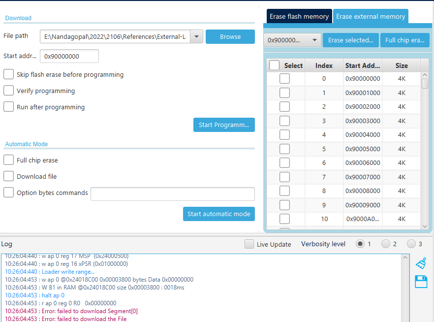

Cube Programmer (v.2.10.0) returns this when trying to program the Flash with a Binary File:

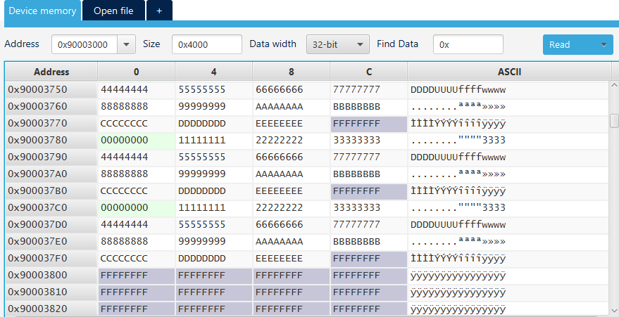

An Interesting thing is that The file does get written till Address 0x900037FF but it fails afterwards as shown here:
I have tried using older versions of Cube Programmer ( 2.8.0 and 2.7.0) but still the same result.

Attaching the Cube Programmer Log ( Verbose Level 3 ) in case it helps

}I checked the data in the Memory Monitor to double check and it was correct as shown.
I even tried writing a Buffer that was bigger so that it crosses the address 0x90003800 and it still worked.

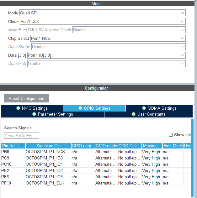

What pins are you using for the OCTOSPI1/QSPI interfacing?

Here are the pin configurations for the OSPI Peripheral interface with the Quad SPI Flash.

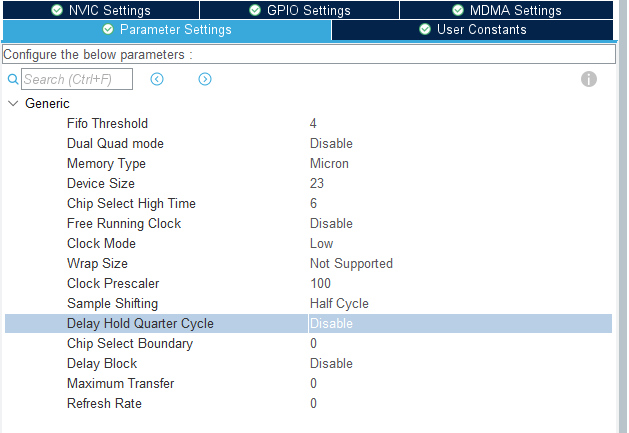

Also attaching the OSPI Parameters that I have used.
