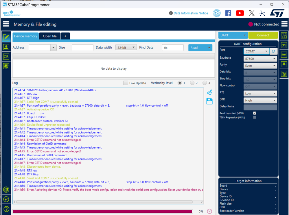

Hello, I'm trying to download the program to the STM32H743VGT6 via the serial port. I keep getting the following error when using STM32CubeProgrammer. Do you have any solutions?

Hello, I used USART1 (PA9 and PA10). During connection, I held down both RST and BOOT0, then released RST first while keeping BOOT0 pressed. However, the aforementioned error consistently occurs.

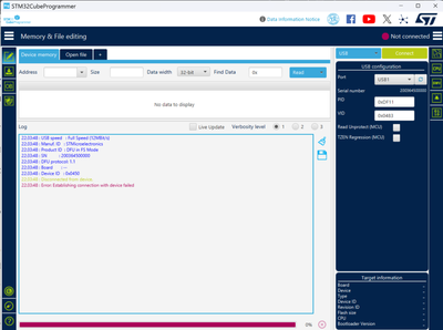

I try to use the DFU, but the error also consistently occurs.
