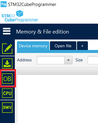

2022-02-07 4:12 AM
Dear @paolog ,
Dual bank is configurable by option bytes. Option bytes settings are available in STM32CubeProgrammer. Click on "OB" button as indicated in the following photo and you will access to all option bytes settings.
2022-02-07 5:29 AM
Thank you for the prompt reply, @Community member
As I wrote, the DBANK bit in OPTR register is set but still the programmer reports 1Mbyte of flash to program (while under the ST-Link windows reports 2MBytes). Is there any other flag I should check?
I didn't mention that the board is a NUCLEO-L4R5ZI.
