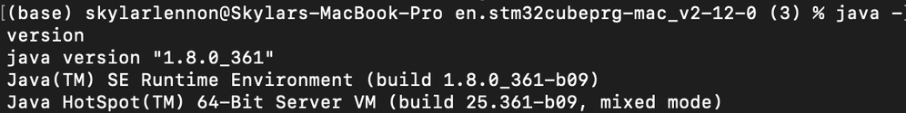

I am trying to download STM32CubeProgrammer on MacOS Monterey 12.6 in order to program a STM32F103C8T6 ARM (BluePill) microcontroller. I followed the directions on this post, but I'll outline what I did exactly.

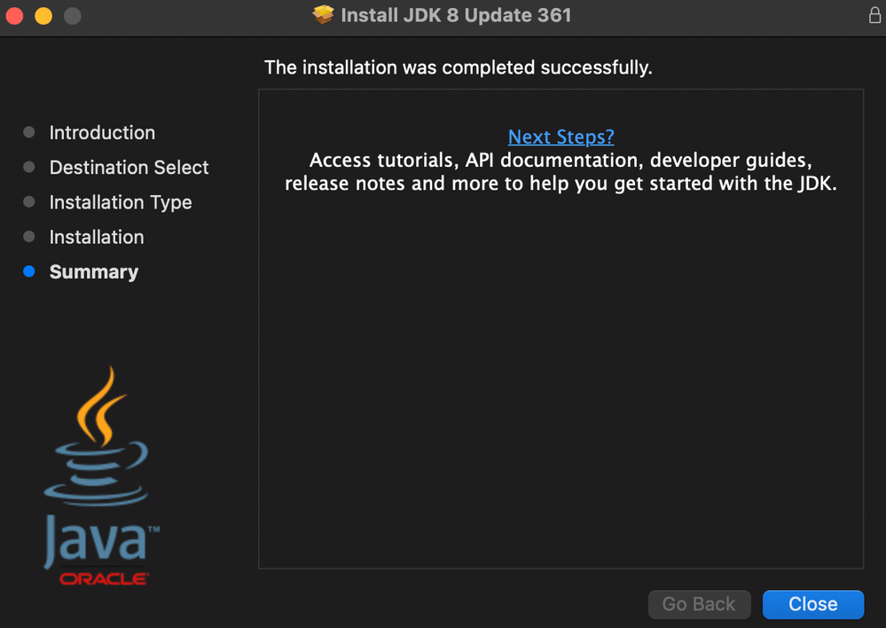

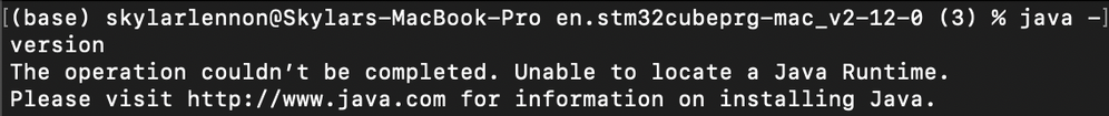

I first uninstalled java:
sudo rm -rf /Library/Internet\ Plug-Ins/JavaAppletPlugin.plugin
sudo rm -rf /Library/PreferencePanes/JavaControlPanel.prefPane
sudo rm -rf /Library/Application\ Support/Oracle/Java/
sudo rm -rf /Library/Java/JavaVirtualMachines

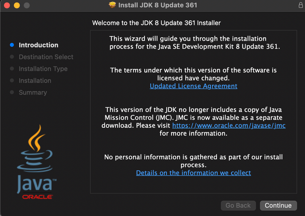

I then installed jdk-8u231-macosx-x64.
Which downloads a different version of Java than the post I was following which I suspect could be part of the problem. I also didn't download the JMC separate download. Not sure if that matters.

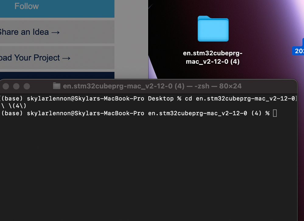

I then downloaded the STM32CubeProgrammer for Mac. Tossed the folder on my desktop, and changed directory to this folder
I then ran the command:
sudo java -jar SetupSTM32CubeProgrammer-2.12.0.exe

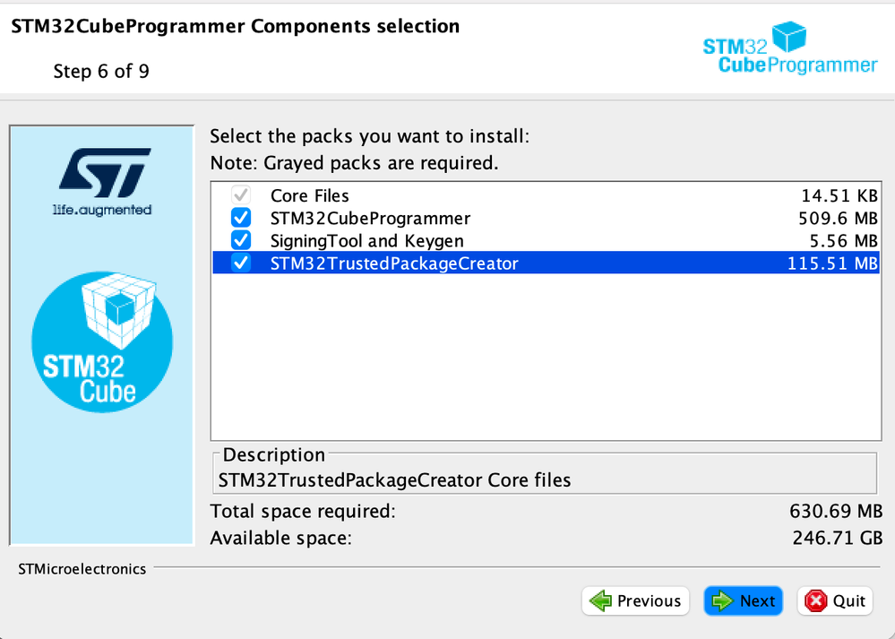

Which brings up the installation wizard for the STM32CubeProgrammer. I followed this and downloaded it to this default location:
/Applications/STMicroelectronics/STM32Cube/STM32CubeProgrammer
Downloaded these files:

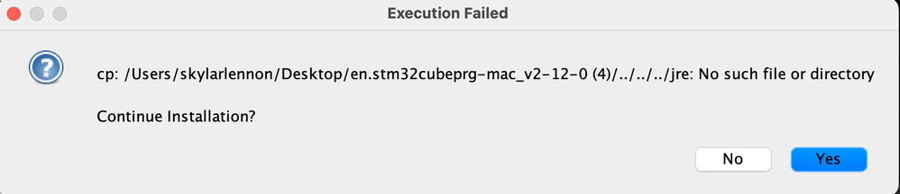

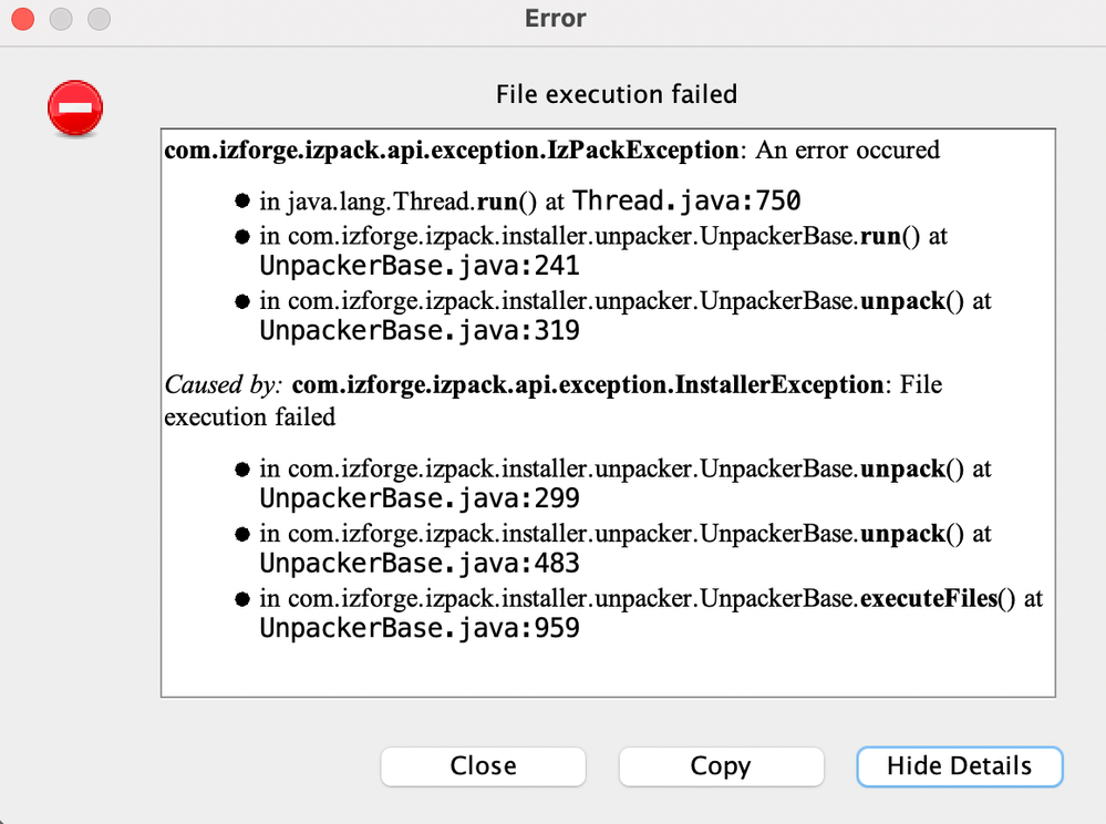

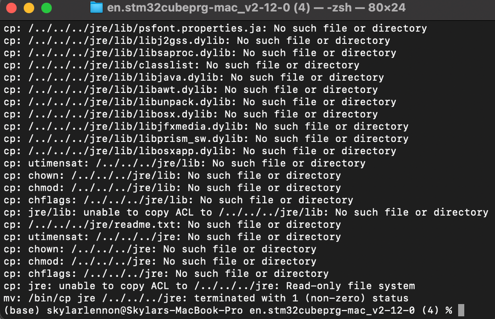

But it gives me this error:
With these details:
Not sure why it's looking for jre 3 parent directories back. I tried to move the jre file there but it's giving me this error:

sudo xattr -cr ~/SetupSTM32CubeProgrammer-macos.app2- In case you used the .exe installer (sudo java -jar SetupSTM32CubeProgrammer-2.12.0.exe.) and the popup occurs during the install indicating the following:
cp: en.stm32cubeprg-mac_v2-12-0/../../../jre: No such file or directory
Continue Installation?
Continue the installation and copy the downloaded jre folder manually into the CubeProg install folder. To do so, please follow the steps below:
- Copy the jre folder from the downloaded en.stm32cubeprg-mac_v2-12-0
- Open CubeProgrammer install folder
- Right click on STM32CubeProgrammer.app and select "Show Package Contents"
- Paste the jre folder
3- After the install, if CubeProgrammer couldn't be launched via GUI, please try to lanch it via CLI as follows,
- Navigate to the /Applications/STMicroelectronics/STM32Cube/STM32CubeProgrammer/STM32CubeProgrammer.app/Contents/MacOs/bin/
- type the command:
java -jar STM32CubeProgrammer- If the jre folder exists in CubeProgrammer install folder, type the following command:
../../../jre/bin/java -jar STM32CubeProgrammerI hope this helps!
