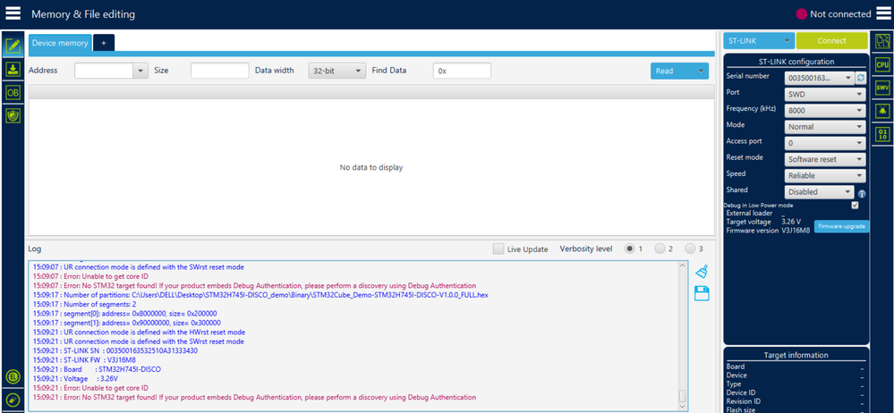

Hi..I have the same issue with STM32H745ZI Disco. I am not able to connect because "No STM32 Target Found" Unable to get Core ID.  Anyone help to solve the issueScreenshot (320).png
