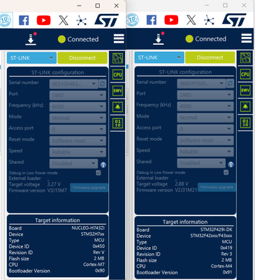

2025-07-28 1:49 AM
Hey KnarfB,
I’ve already tried that. See, whenever I connect one ST-Link in STM32CubeProgrammer, it connects successfully. But when I open another instance of STM32CubeProgrammer, it’s unable to connect to the second ST-Link.
I suspect this is because all instances are targeting the same DLL. What do you think?
