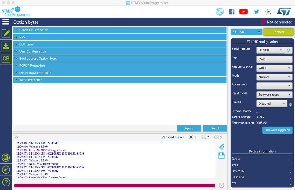

While fiddling with H745 board to investigate how dual core works, after modifying option byte to BOOT_CM7 = 0 and BOOT_CM4, STM32CubeProgrammer (nor STLINK-gdbserver) refuses to connect to the board with "Error: No STM32 target found". The ST-Link itself is okay. Here is a log from the programmer.
22:31:39 : ST-LINK SN : 002F003D3137510E39383538
22:31:39 : ST-LINK FW : V3J5M2
22:31:39 : Voltage : 3.30V
22:31:39 : No STM32 target found!
22:31:39 : Error: No STM32 target found!
How do I regain access to the board?

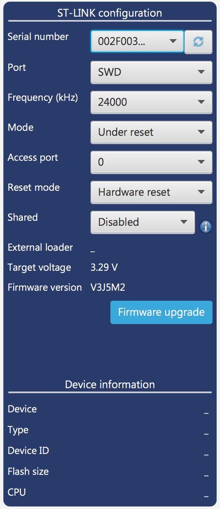

Did you try to connect under reset (Reset Mode -> Hardware reset)
How does the "connect under reset" supposed to work?
I configured the ST-LINK as follows and pressed "Connect" while reset button is held down, but it gives the same error, regardless of the reset button state.

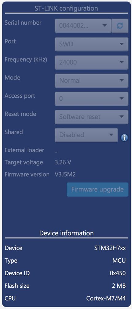

Here I have two NUCLEO-H745ZI-Q boards, from the same order, and one of these (call it BOARD1) can be connected:
12:22:35 : ST-LINK SN : 0044002D3137511239383538
12:22:35 : ST-LINK FW : V3J5M2
12:22:35 : Voltage : 3.27V
12:22:35 : SWD freq : 24000 KHz
12:22:35 : Connect mode: Normal
12:22:35 : Reset mode : Software reset
12:22:36 : Device ID : 0x450
12:22:36 : UPLOADING OPTION BYTES DATA ...
12:22:36 : Bank : 0x00
12:22:36 : Address : 0x5200201c
12:22:36 : Size : 308 Bytes
12:22:36 : UPLOADING ...
12:22:36 : Size : 1024 Bytes
12:22:36 : Address : 0x8000000
12:22:36 : Read progress:
12:22:36 : Data read successfully
12:22:36 : Time elapsed during the read operation is: 00:00:00.001
However, when switching board to the problematic one (call it BOARD2), then it fails to find a target.
This started to happen when I tried to write BOOT_CM7 = 0 and BOOT_CM4 = 1 instead of previously working BOOT_CM7 = 1 and BOOT_CM4 = 0 pair. This write to OB in fact failed with a message from the programmer (something like "Option byte write failed").
If the BOOT_CM7/BOOT_CM4 bit actually has nothing to do with the connectivity problem, then I have to find why the target is not responding on BOARD2 and how to recover it.
Thoughts?
Btw, physical connection is just a USB cable for both BOARD1 and BOARD2. Please note that ST-LINK itself is responding, so the problem lies behind ST-LINK.
