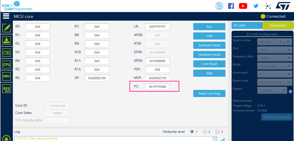

First of all you have to check that you are booting on bootloader.
To do this you can connect to SWD interface with STM32CubeProgrammer and use the MCU Core Register panel where you have to read the PC content.
This will help us to guide you in understanding the problem.
