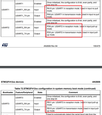

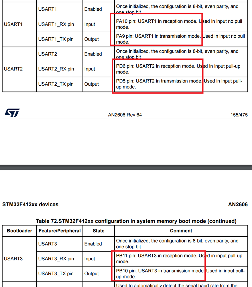

The system bootloader needs this UART config otherwise it won't work.
In conclusion, you need to redesign your PCB or make a patch on your board.

I'm using UART2 for flashing i.e., PA2-Tx, PA3-Rx and selected UART as interface
But as I indicated in my previous comment USART2 is using PD6 and PD5 for communication not PA2 and PA3!
Please review the AN2606 / section 34 STM32F412xx devices

In my custom board I don't have PD6 and PD5 pins, Is there any other way to flash my hex file using UART
Or I need to redesign my board?
2024-10-09 3:18 AM
