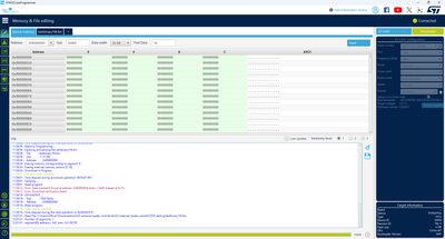

Also, you can see the test binary contents:

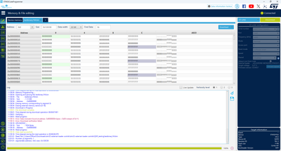

And the readback:
So verification is rightly failing becuase the writing oft he data is not happening for some reason?
I can load/debug and operate QSPI directly from sourcecode in the main IDE so we know HW is working properly.
