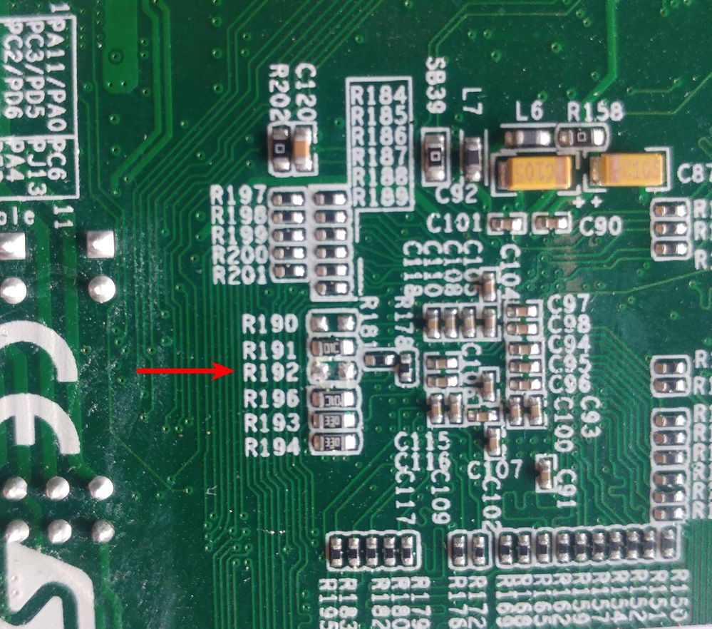

2019-12-13 9:41 AM
Thanks you very much,
In STm32H747I-DISCO the BOOT0 is connect to R192 and this one to + 3.3V. View image
Solved.
