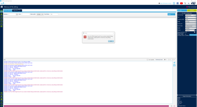

Hello, I’m still a complete beginner. I’m using an STM32WB55 board with the STM32CubeProgrammer. I’ve already flashed a few things onto the board, but currently, I can no longer connect to the board. Does anyone know how to fix this error?

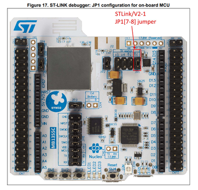

Could you check the Jumpers of your Board Specially the JP1. It should be fitted exactly as mentioned on the Picture:
Also, don't forget to use the CN15 USB port and not the CN1 to connect the Board (with a USB Data Cable and not just a Charging Cable).

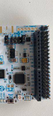

I believe I have placed the JP1 jumper correctly, but unfortunately, it still doesn't work. I am also using the CN15 port with a data transfer cable.

I tried it with the settings here; hopefully, they are correct as you mentioned. Additionally, I performed a firmware upgrade and tried a different cable, but unfortunately, I am still getting the error message.
2024-09-05 5:54 AM
> Target voltage: 0 V
The board won't work without power. No software settings can fix this.
Do you have a multimeter? Perhaps look at the schematic to figure out where and why the voltage rail isn't getting established. Is a chip getting unexpectedly hot? Could be damage to the board due to an unexpected voltage spike or other event.
