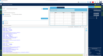

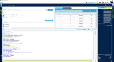

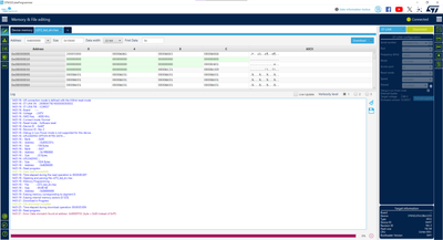

2024-12-29 4:07 AM - edited 2024-12-29 5:51 AM

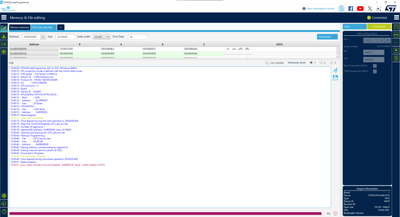

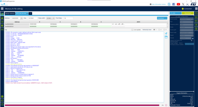

I downloaded the lastest version of cube programmer v2.18.0.
Tried via DFU and ST-LINK on 5kHz, 100kHz and 4000kHz.
Tried with STM32L072KZU7 and STM32L072RBT6
DFU, STM32L072RBT6, simple load and verifying
DFU, STM32L072RBT6, erasing & programming and read again
PS: when i tried full chip erase over dfu, usb disconects and cube programmer stuck
ST-LINK, STM32L072RBT6, simple load and verifying
ST-LINK, STM32L072RBT6, erasing & programming and read again
STM32L072KZU7, other ST-LINK, simple load and verifying
I can't show dfu on STM32L072KZU7 because on board no usb connector
2024-12-29 4:10 AM - edited 2024-12-29 5:56 AM
With tab Erasing & Programming corrupted another cells [sorry, it was a different hex file, please ignore this message, I replaced the screenshots above with the correct ones]

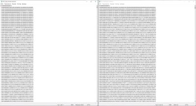

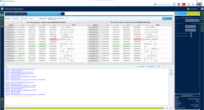

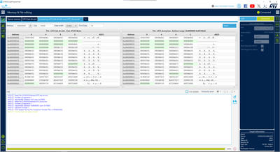

2024-12-29 6:03 AM - edited 2024-12-29 6:07 AM
I load bin firmware [L072_led_drv.bin] via DFU, and save it as hex file via cube programmer [L072_dump.hex]
Compairing dump and bin file:
Compairing saved hex and generated by cubeIDE firmware hex
The file generated by cubeIDE also has a different format than the file saved by the cube programmer
