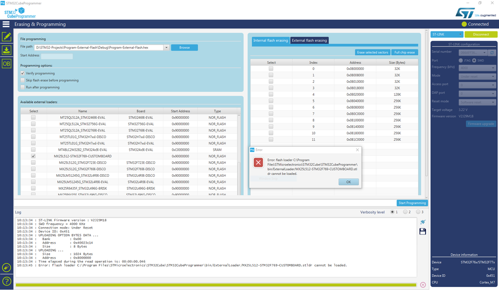

I am new member of STM32 MCU. I'm working
on a custom board based on a STM32F7 MCU for a GUI projects. In my projects, I store a lot of data for GUI such as: Imgae data, Fonts, Audio data in QSPI Flash. My MCU is STM32F769NI and my QSP Flash is MX25L512, that is same of STM32F769I - Discovery. When I use STM32CubeProgramer to program the demo file supply by CubeMX Driver to my board then every thing is OK. But When I build my external loader then change file
extension
from *.out to *.stldr (I am using IAR ) this error is appear. My external loader is follow example in ''C:\Program Files\STMicroelectronics\STM32Cube\STM32CubeProgrammer\bin\ExternalLoader\N25Q256A_STM32L476G-EVAL_Cube''. In my program I use BSP funtion supply by CUBE MX, and I check funtion by funtion same work. I'm stuck in this problem. Where is my error. I attack my project in this post. Can every one help me ? Thank you !!!

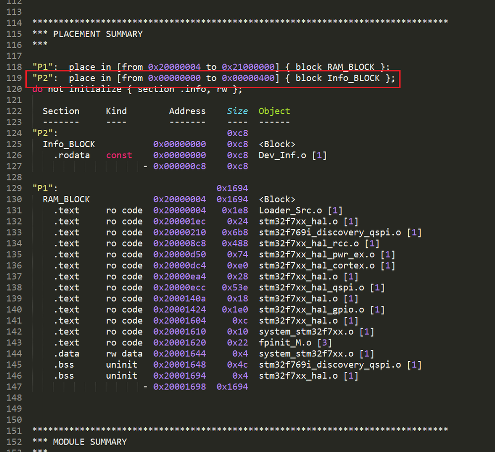

Your ICF File doesn't look ok. You need to consider that the external loader will be moved to the ram and executed from there.
I use this in the ICF:
define symbol __ICFEDIT_region_RAM_start__ = 0x20000004;
define symbol __ICFEDIT_region_RAM_end__ = 0x21000000;define memory mem with size = 4G;
define region RAM_region = mem:[from __ICFEDIT_region_RAM_start__ to __ICFEDIT_region_RAM_end__];define block RAM_BLOCK with fixed order {readonly code, readonly data, readwrite };
define block Info_BLOCK with fixed order { readonly data object Dev_Inf.o};place at start of RAM_region { block RAM_BLOCK };
place in RAM_region { block Info_BLOCK };do not initialize { section .info, readwrite };

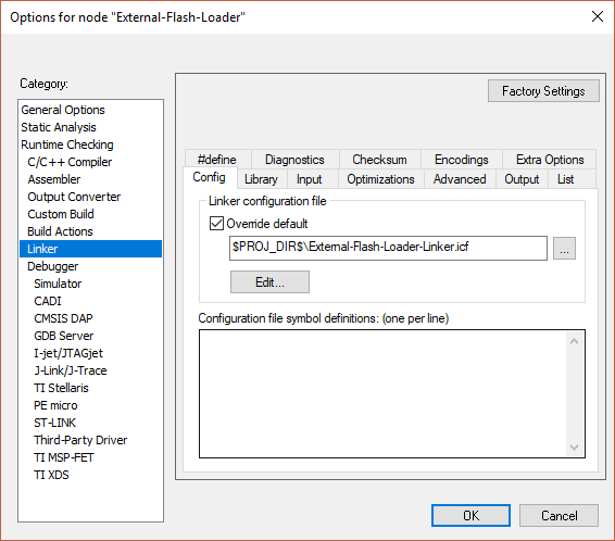

Hi Thanks for your quickly reply. In properties of project I select tab Linker - > I chose override default linker to select my External-Flash-Linker.icf file then I copy all your comment code of linker at this file. But after build project I see in the map file ''P2'': place in [from 0x00000000 to 0x00000400] { block Info_BLOCK } is not correct. What is wrong ?.
