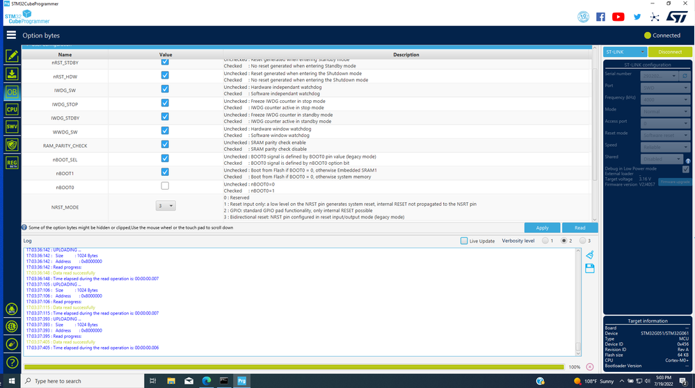

It looks like
nBOOT_SEL was checked which meant BOOT0 signal is defined by the nBOOT0 option bit"
nBOOT1 was checked which meant Boot from Flash if nBOOT0 = 0, otherwise from system memory
nBOOT0 was checked nBOOT0 = 1
This caused it ti boot from system memory.,
I changed nBOOT0 to unchecked where nBOOT0 = 0
So that should have fixed it and cause it to boot from Flash. I am still having the same problem.
I wondered if it was an issue with the project getting upgraded from 1.9.0 to 1.10.1 so I made a brand new project and it has the same problem.

It looks like it did not change.
But the programmer says it did.

Could it be it booted into the system because I am running the debugger?
2022-07-19 3:48 PM
That CubeProgrammer description of nBOOT0 and nBOOT1 options is a nonsense. Again a blind trust without checking the real thing - reference manual...
Look at the RM0444 Rev 5, 2.5 Boot configuration, Table 8. Boot modes.

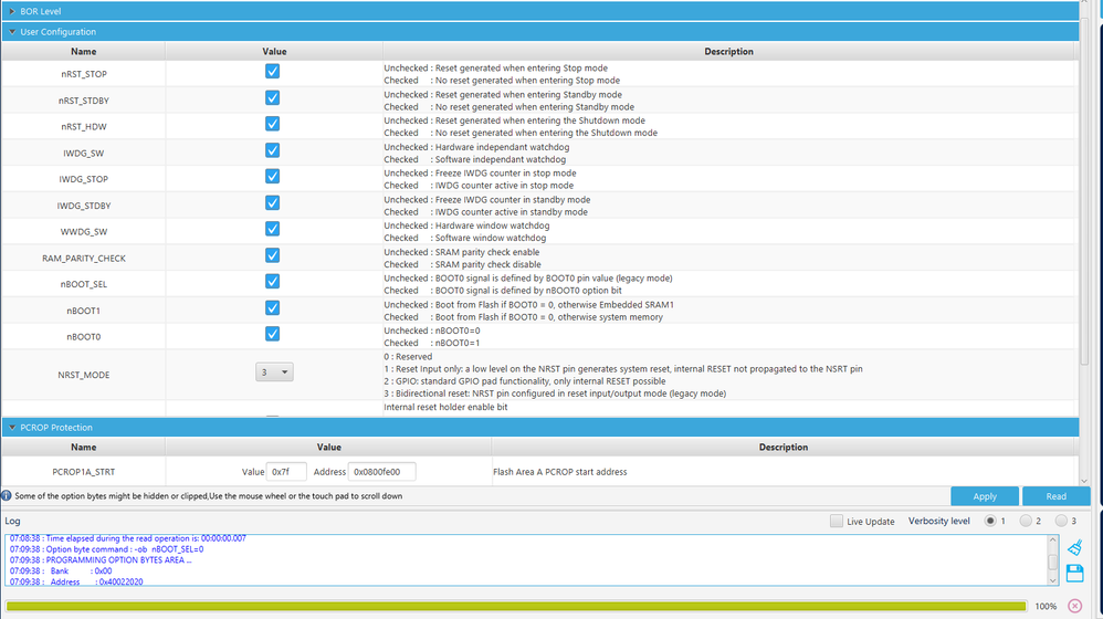

2022-07-20 5:34 AM
Thanks for the pointer. And yes I should be wary of ST software.
Looking at Table 8 the 4th line is a way to get to Main Flash Memory.
nBOOT_SEL bit needs to be 1
nBOOT0 bit needs to be 1
nBOOT1 bit does not matter
BOOT0 pin does not matter.
I thought that is what I started with before I started changing the fuses!
It must not have been, because the PC Changed and the test code works.

2022-07-20 5:40 AM
I also have to thank KnarfB for the pointer to the fuses. I have no idea how they got changed. I had to load the programmer into my computer to change them. I looked at fuses a long time ago, but have not changed them in a long time.
