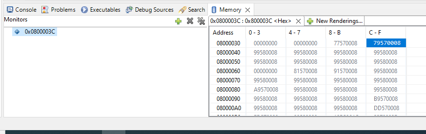

2022-07-18 11:50 AM
Open the memory view at 0x0800003C and check whether it contains the SysTick_Handler() address.

2022-07-18 12:44 PM
From the .map file.
.text.SysTick_Handler
0x0000000008005778 0x8 ./Core/Src/stm32g0xx_it.o
0x0000000008005778 SysTick_Handler
Why is it off by 1? 0x08005779? Should be a number divisible by 4 I would think.
It looks like all the vectors are odd numbers.

2022-07-18 12:48 PM
LSB 1 indicates thumb mode, looks correct.
