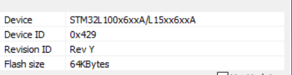

I am trying to program a generic STM32L151C8T6A via STlinkv2
If I use STM#@ ST-LINK Utility I have no issues and this is what it detects:
14:56:17 : Device ID:0x429
14:56:17 : Device flash Size : 64KBytes
14:56:17 : Device family :STM32L100x6xxA/L15xx6xxA

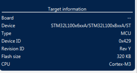

When I try using the STM32CubeProgrammer it detects the following:
Device ID 0x429
Flash size 320KB
Device STM32L100x6xxA/STM32L100x8xxA/ST
Revision ID REV Y
If you try to do anything it gives the error "Flash Driver cannot be loaded"
This is on the latest 2.5 version but I also tried it on v2.2 which detected 128KB and also failed.
So the two differefnt ST programing software options detact the same device ID but a different chip and flash capacity.
