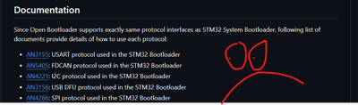

Is FDCAN Systembootloader described in AN5405
supported by cubeProgrammer or the CLI tools?
Because i only see the CAN (classic) option

Im a bit confused howcome all examples for Openbootloader are supporting FDCAN and no CAN, i guess ill need to add CAN interface myself
